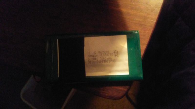

I have a small portable, rechargeable radio I use outside at my cabin. About the size of a deck of cards. Goes dead after a couple of hours. 3.7v battery, like a cell phone. I also have a bigger 3.7 v battery out of a portable TV that died that I could tape to the radio. But the radio battery has 3 brass connectors, the TV battery has red and black wires only.
Can I use it, either by itself of connected with the radio battery?

Hmm, glad you mentioned that. TV had a 9v wall wort. Which got me thinking, how would that do with a 3.7 battery. So I just had another look at it, looks like it says 3.7x2.
# Posted: 7 Jan 2020 11:04pm - Edited by: ICC
Quoting: paulz it says 3.7x2
So that may mean 3.7 volts x 2 = 7.4 volts as in serially connected. It strikes me as an odd labeling.... makes me wonder why they don't state 7.4 volts???? Do you have a multimeter? Measure the voltage.
3.7 x 2 could also mean connected in parallel. ??? Anyhow, measure the battery volts. It may very well be that connecting that to the radio would not be good.
If the radio has a USB port how about trying a power bank plugged into the radio with a few elastic bands holding them together?
# Posted: 7 Jan 2020 11:45pm
7.9 volts. Good thing I didn't start farting around with it. Power bank, good idea. Don't have one of those things yet.
