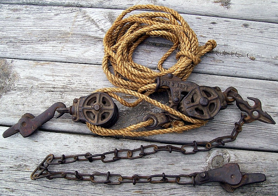

Does anyone know how to rig this up to stretch wire. I know I need rope for the double block and the grip is used on the wire. I have used modern equipment to stretch up barb wire but not sure how it works. Thanks

Looks like you need another block

Neb , I think cooner is right , you need another block, rope etc. You can adjust the distance from this sheave, to the wire grip then by hooking the chain at the desired chain link, over the horn of the sheave. Nice old tools, I have a few in my shop as well.old243

Littlecooner >>> yep that is exactly what it is missing. I have two of these different but will see if I can make one out of two. Thank you.

old243 >>> yep I see how it will work by hooking the chain in the anchor to hold it. What confused me was how it would work but now I see that I need one more block. Thanks and have you ever used yours old243?

I have used my rope blocks to stretch barbed wire lots of times. I had cattle so fence fixing was an ongoing thing.There is a type as well to stretch woven wire. There are two metal or wood bars that clamp or bolt over the wire Then two sets of pullers that anchor to a corner post. Don't know if this makes sense. Local co-op would lend them to you , if you bought a roll of fence from them. old243
