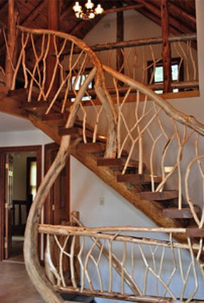

Here's a stairway you can build yourself with a chainsaw and some wood for about $1000 dollars. Unfortunately, you need $200,000 for the cabin to have someplace to put the stairs!!!
LOL. 😱

Nice looking stairs darz, but there would be a problem with those branches that make up the ballusters. Lots of places for a kid to get stuck and hang by their neck. That is why we have the 4" ball rule.... openings cannot be any larger than 4". The reason being that a larger opening may allow a child's body to pass through and then the child may get hung by the neck when the head cannot pass through. Similar rule on cribs for kids. I would hate to build something as creative and then have a grandchild die as a result.
