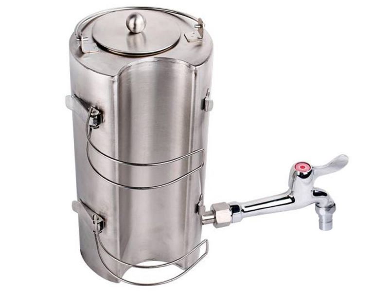

# Posted: 17 Feb 2017 10:38pm
This is another type. I have this one for the wood stove in my tool shed. It clamps on the stove pipe. It holds 2 quarts.

Darz5150: What is the make and model of your water heater?
# Posted: 21 Feb 2017 10:21pm
@rockies
It came with the stove. Got it on amazon. Just search TMS military tent stove. They are about $90 bucks now.
# Posted: 21 Feb 2017 11:26pm
http://www.ebay.com/itm/Stainless-Steel-Outdoor-Water-Kettle-for-Wood-Military-Campin g-Stove-Flue-Pipe-/400692352328
