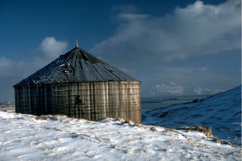

Back in WW II, the U.S. Army built water tanks from redwood on Adak Island (about 1200 from Anchorage in the Aleutians) during the buildup on Adak in preparation to attack the Japanese who had invaded the islands of Attu and Kiska. When I was there in the 70s, one of the tanks had collapsed, probably due to the failure of the steel bands around the circumference. I salvaged some of the redwood for furniture projects; it was some beautiful wood under the weathered silver-gray surface. Each vertical "stave" was 4 inches thick by 6 inches wide by 20 feet long and perfectly preserved. I don't know if redwood is available to use in the construction of a water tank, or cheap enough if available. but it should be able to weather most any climate. Cedar or cypress might be other options. The photo is a redwood tank that was built on Adak
# Posted: 1 Jul 2015 12:43pm
I worked in a millwork shop for a while and we got in different kinds of redwood tankwood from time to time. The stuff that held water alone was generally degraded from years of holding water. It wasn't rotted but was punky and obviously had lost mass to fungi or whatever. But the wood that had held wine or brine was better, presumably because they inhibited fungi.
But any wood sitting in the cold environment of Adak must be well preserved. You're lucky to get ahold of it. Not a chance you would see anyone construct large water tanks out of redwood now. The days of cheap high quality redwood readily available are long gone. If you see old growth redwood for sale anywhere you know it came from the last few remaining stands and probably should not have been cut. There is plenty of second growth R-wood available but the quality is so poor I'm not sure I'd want to use it for a water tank.
Don't know for sure but I'm going to guess that a water tank made from cedar or otherwise would be cost prohibitive. They used to do it just cause wood was so cheap in the heyday of 'cut now and think later'.
