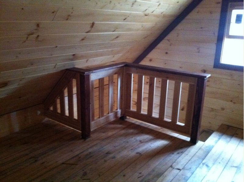

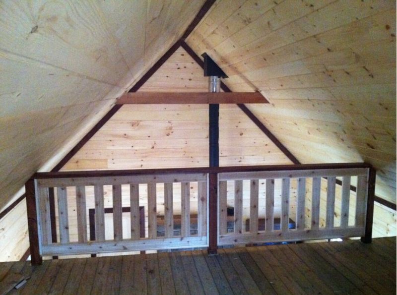

I mostly finished the railings on the edge of the loft and the railing around the stairwell. Getting these done enclosed the space a little bit and made the area feel more like a room.

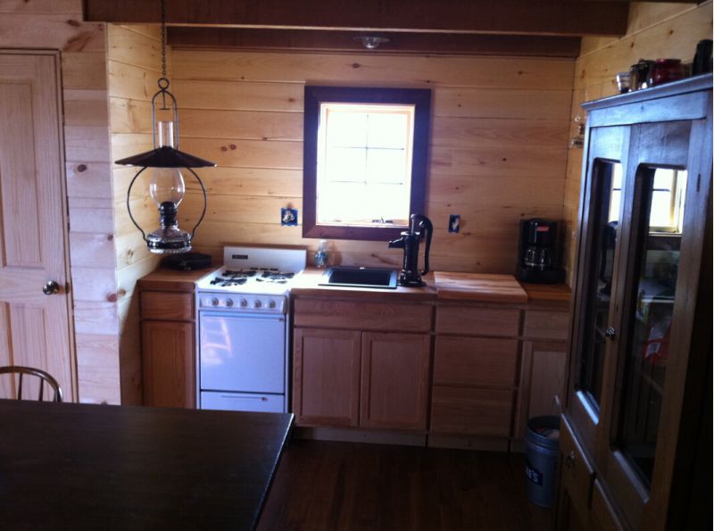

I got the kitchen components installed. The stove I talked about in a previous update is working-out really well. At one point, while I was cooking breakfast, I had all 4 burners going at once. I would have preferred the stove in black, but Lehman's told me I would have to buy 6 stoves to get black. So I went with the white. I had intended to build a wood countertop myself, but I came across a wood butcher-block countertop at IKEA and bought that instead. I like it and it has allowed me to avoid any composite or non-natural surfaces in the cabin other than the stone veneer hearth.
The pitcher pump is not hooked-up yet. I intend to put in an underground cistern to collect rain water next year. I am looking at buried, off-the-shelf plastic tanks in the 300 to 600 gallon range. The tank will be supplied by roof run-off and the pitcher pump will be connected to the tank. The sink currently drains into a 5 gallon bucket, but I will drain outside (through the cabin floor) when the cistern get hooked-in.

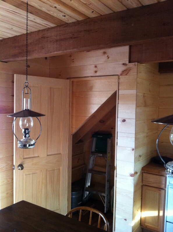

The closet/pantry that I built under the staircase has a small section of wall behind it as the staircase runs through there (see picture). I saw this coming during the design phase, but decided I did not feel like cutting the corner off a pre-hung door. Guests at this cabin will be encouraged to sign their names to this wall section. When this wall is full, I am sure the tradition will spill over onto the floorboards above. I like the idea of people who visit there becoming a part of the cabin.

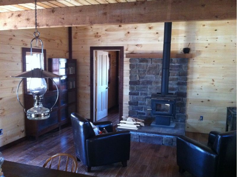

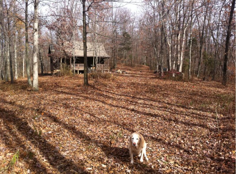

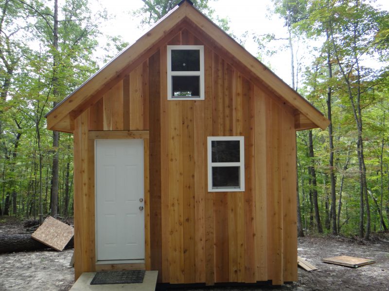

The cabin isn't actually finished. In some ways it will never be finished, but I am down to a final punch list of odds-and-ends. Some of it won't be done until next spring. Some of it may never be done.
I have documented my construction process here on the forum, in real-time, for the last 21 months. I am now to a point where I see no more substantive updates to the construction thread. I will still be hanging around the forum and I plan to start a new thread to capture other projects and activities at Blaine Hill that are not directly related to cabin construction.
When I started this project, it was important to me to publicly document the process in some detail as a way of paying-back/paying-forward all of the valuable information I was able to gather from others who documented their projects here on the forum and other sites. I don't know the best ways to build a cabin, but as a point of reference, I told you exactly what I decided to do.
It's inevitable that this thread will slip deep into what can only be considered the archive pages of the discussion forum. I hope a future cabin builder will come across it, see something here that they either like or don't like, and in that moment make a design decision about their own ideal cabin. Good luck.

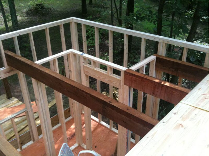

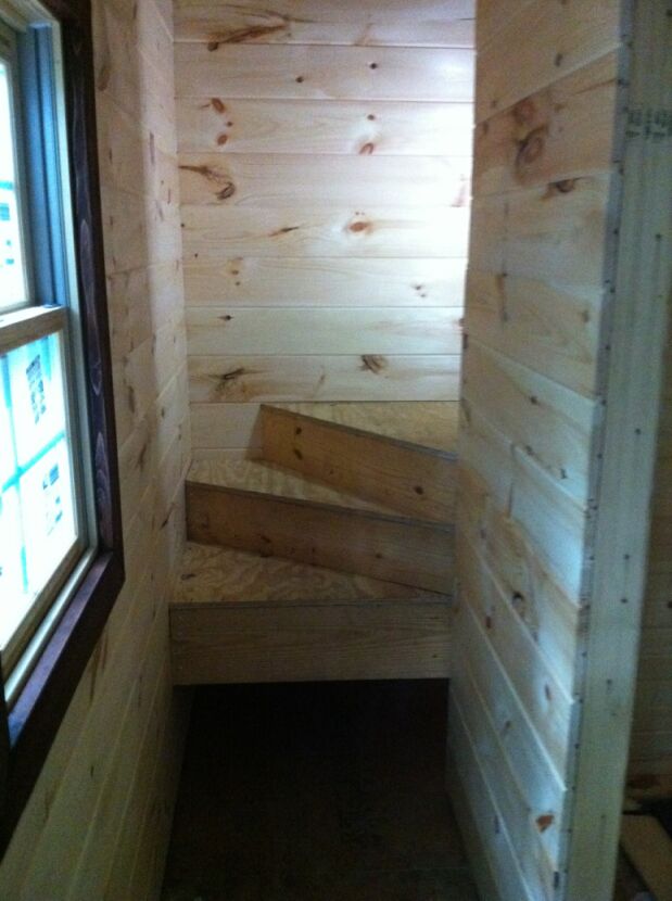

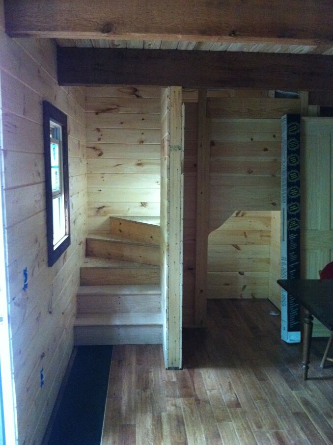

BlaineHill -would you be able to give a bit more detail on how you set up your beams and stair case? Looks like you rested your beams on a couple of 2x4s sistered to studs. Your end beams resting on stairwell 2x4 walls?
you happy with your corner stairs? (Am wrestling w/doing something like this or just ladder type thing to save space)

When I built the wall sections, I built beam supports into the walls that consisted of two 2x4's and two 3.5" wide strips of ½" OSB. Sandwiching these pieces together gave me the full 4" I need to fully support the beam. These supports had a full length stud on only one side. I did not want to wrestle these 4" beams into a 4" slot. The additional studs required to complete the slots were added after the beams were installed. The beams are exactly 16' long which is the width of the cabin from the outside face of one stud wall to the outside face of the other. Having these beams pre-cut to the exact length helped me plumb the front and back walls of the cabin.
I have been very happy with the corner stairwell. It's only 32 inches wide, but seems very adequate. I was prepared for it to be quite steep, but it did not turn out that way. People (and pets) who might not be comfortable with a ladder have no problem walking up there. Stair-building is a real art form, and I had never built a staircase before, so I built it the way I could see it. The first thing I did was complete the 1x8 T&G on the walls in the stairwell/closet. Then, I built 3 stair "boxes" to complete the corner transition. The lower section and the upper sections of the stairs were built with regular stair stringers. Then I covered the whole thing with oak risers and treads. Even a simplified approach like this required a lot of planning to get everything right. There was a sneaky 1/8" inch I was chasing around for awhile. It was hiding in the corners and edges and I am not convinced it isn't still in there somewhere.
