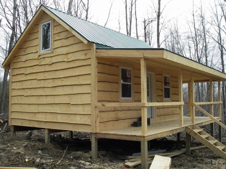

But it will look something like this.

This style of roof built with prefab trusses is stronger and less likely to leak and cheaper than a add on porch .
prefab truss
prefab truss

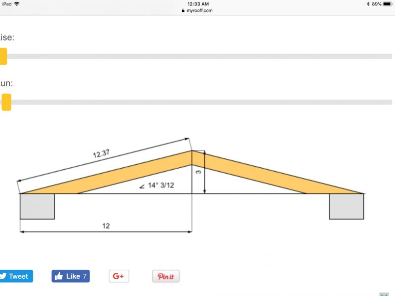

A 3/12 roof is pretty flat.
3/12 roof pitch
3/12 roof pitch

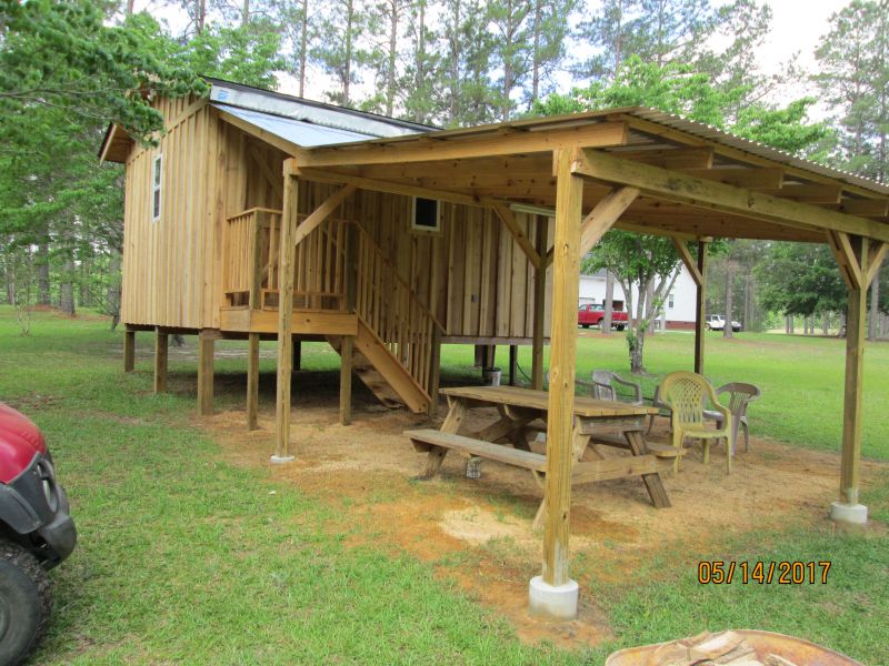

The project is completed now, I ended up going with a 4/12 pitch.
Completed Cabin
Cabin
Cabin
# Posted: 30 Nov 2017 06:47am
WOW, now That's what I call a Porch ! lotta room to sit under and relax and enough space to even tinker on things too in shade etc... Like It !

Curious why so high off the ground?
Cabinmonkey
# Posted: 4 Dec 2017 02:03pm - Edited by: Cabinmonkey
Quoting: Big Ed
Siding is raw, untreated wood; I didn't want backsplash to cause it to discolor or rot. It also gave me the elevation to extend the porch out further. And, it is easier to get underneath to install plumbing.
