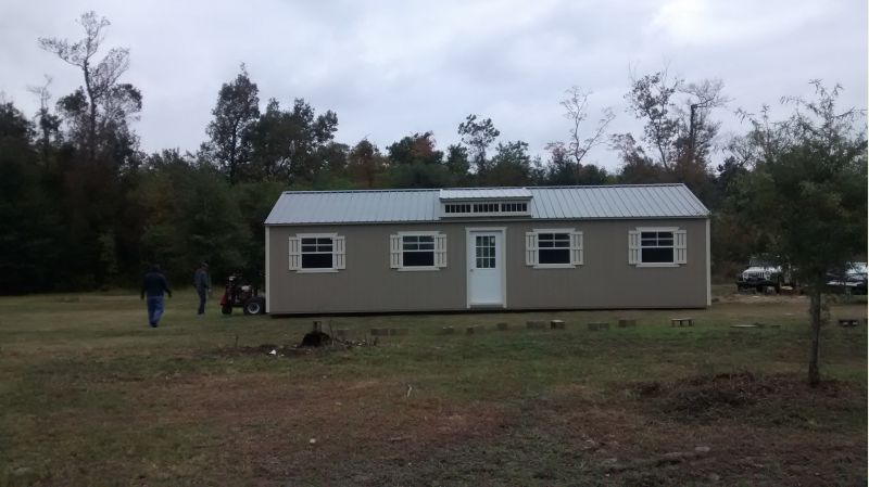

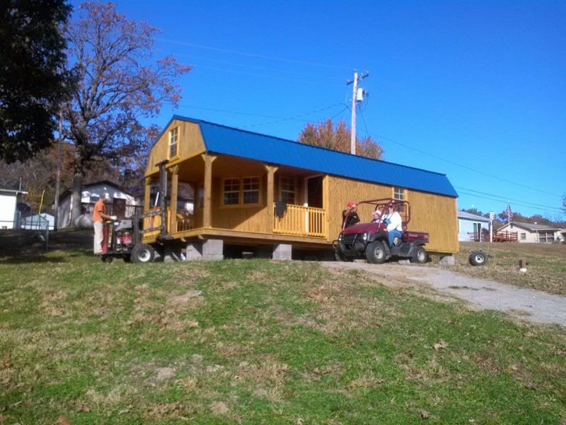

Hi everyone, I've been researching purchasing or building a cabin
for over 2 years. We purchased 2.6 acres in south east Texas 13 months ago and have been clearing it for most of that time. We live in Houston which is 125 miles away. Almost every weekend for the last 13 mths we've spent on our property cutting weeds, mowing and burning tree limbs, stumps and debris. Finally it looks somewhat like we want it, still alot to do. My wife found a cabin on Derksens website that had a lot of curb appeal so we decided to check them out, I was pleased with the quality, but felt the price was a little high. I weighed the pros and cons, especially our time and concluded this was our best option. We just got it delivered today, and will start working on it in the upcoming weeks.

Looks nice.
We had a 16'x40' 2-story 'shed' put up on our 94 acres in upstate PA this summer. Looked at many options but the idea of a cabin being built in a couple days with the exterior completely finished was too appealing not to do.
We are finishing the interior as time permits. Once the inside is finished I'm going to build a more 'rustic' cabin on another part of the property along a stream that divides the property roughly in half.
I like to rough it from time to time but this time of year I'd rather have some extra comforts.
Enjoy it. Maybe some pics of the interior?

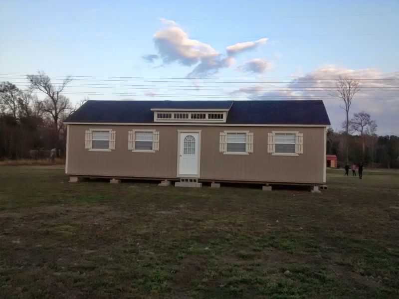

Hi, sorry it took so long to reply but my wife and I have been through quite an ordeal with our cabin. The cabin that was delivered to us was the wrong on, had the wrong roof on it, so we've had to wait to have the right one built and delivered. It was finally delivered on Dec 10 and the old one taken away.

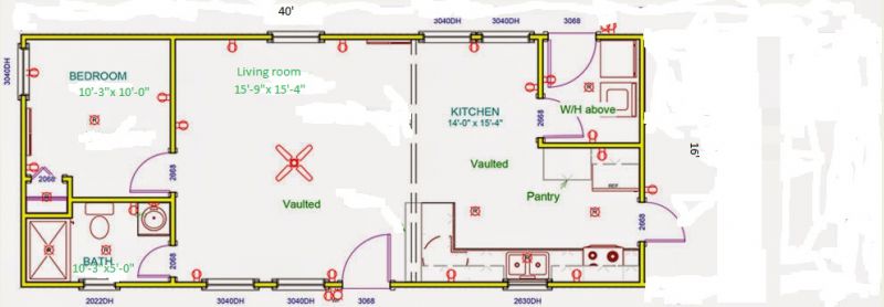

Hi, everyone just wanted to give a little update, the cabin is basically untouched since we purchased it, we plan on starting the interior framing tomorrow, here's a copy of the floor plan.Its not to scale and the door and window sizes are not correct, I just modified an existing floor plan
# Posted: 6 Feb 2015 01:42pm
That looks quite workable on paper... I'd make one small suggestion though... before you start framing things up, mark out the walls & doors on the floor with masking tape and "walk through it" and check your door swings etc... do your kitchen counter spaces too... better to tweak it like that and having to swing hammers & pry-bars later.
Have you considered putting the laundry & washroom together ? as opposed to opposite sides of the house, you'll combine space & give yourself a bit more "living room" while shortening your plumbing & electrical runs. That would also save you a bit on materials but also the amount of hot water you'll use.
In my own build, the farthest my On Demand water heater will be from a tap is 4 feet as I am installing it on the wall between kitchen & washroom.
