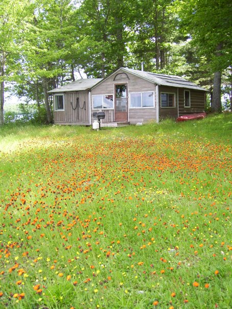

My wife and I inherited an old log cabin on an island. The cabin belonged to her father and he liked the rusticness of it ...my wife and I do not. We have decided to build new and remove the old camp. I have limitations..#1 I am on an island, but that is more a good thing than bad. #2 It is a government lease, originally 5 acres shared by 3 camps which had to be separated and divided into 3 1 acre lots. The problem being where I sit I could only get .5 acres....its ok, because I have the best lot on the island. The log camp is literally 5 ft from the water in the spring...damp ground conditions make it hard to maintain and it is in a state of disrepair. I want to build new...and move back away from the water, and use some of the logs from the old camp as the dividing wall between the living space and bedrooms, and possibly build a 12x12 sleeping camp. Keep in mind the old camp needs thousands in repairs...and hours of back breaking work to get it up off the ground, and would still be sitting on wet ground.

i would tear off those additions and get back to the original log cabin then have a look at lifting it off the wet ground

I can see why you want to avoid fixing the old one, historic as it may be. Jacking it up is the easy part, but there is nothing worse than trying to put in a decent foundation with an existing building in the way while you are doing it. Back breaking doesn't begin to describe it. Log buildings are only permanent if carefully maintained, sounds like this one wasn't. Wet ground is the wrong place for logs- I bet your sill logs are totally rotted and stink of mildew. Yuck.
Rip it and put in a well-built structure that won't be rotted and useless for your kids when you are gone.

you could find out who locally does cabin lifts. my dad lifted his cabin for a few hundred bucks. the guys he found do it all the time. have all the tools. took two days. 10 years later it's still perfect.
and that cabin looks pretty good on the outside from the one pic. not be the best windows maybe. but what a gorgeous field in front. wow. somebody knew what they were doing. funny how wild flower gardens never are. smile.
