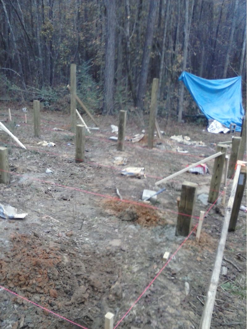

Hello to all,
We bought 5 acres 3 years ago and are finally gonna build a 12x16 cabin on it starting this Sunday. Its gonna be a pay check to pay check build staring with $600. Should be enough to build foundation, floor, and frame the cabin. We are using a post and pier on cap blocks and 4x4.16 centers on framing. I will keep you informed and keep all the other great post coming. Has been an awesome inspiration for me and my family! Will post receipts as they come in, I know a lot of people are looking for budget builds, lets see if i can pull it off.

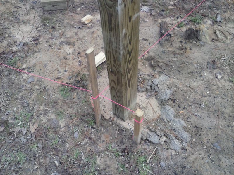

Have more cap blocks and post to go....osb floor and wall frames next week

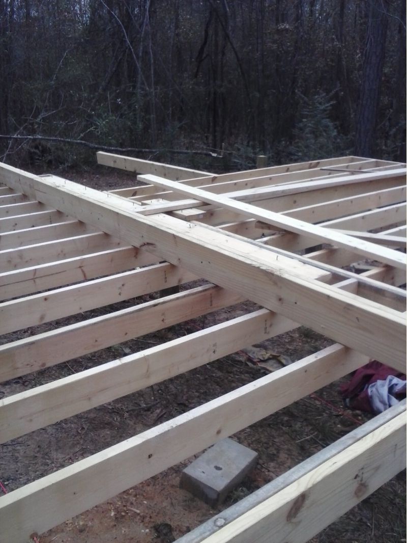

You are going to want joist hangers for each end of those floor joist where they attach to the rim joist and you need to find a different way to anchor that floor to the post. As you add weight, its going to shear off those nails between rim joist and post. Add a cleat to each side of the post where the rim joist it, treated, run it clean down to the concrete pad and nail it in place or bolt it. Or cut the post off and set the rim joist right on top of the post and secure it with some strong ties. Gusset the post also to keep it from rocking. Good luck, its loads of fun.

yea I know, its just temporary for now...waiting on 4x6x20 x2 from the local mill, I will set that on 4x4 under floor, will have finished by next Monday and post...yeah in the pics its just holding it up for now.
thanks for the input dough
the 1x1 acts as a "hanger" there over rated and expensive, this is a budget build ...gotta trim da "bottom line"
# Posted: 3 Oct 2013 09:06pm - Edited by: toyota_mdt_tech
The 4X6 will easily do the job.

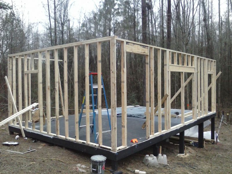

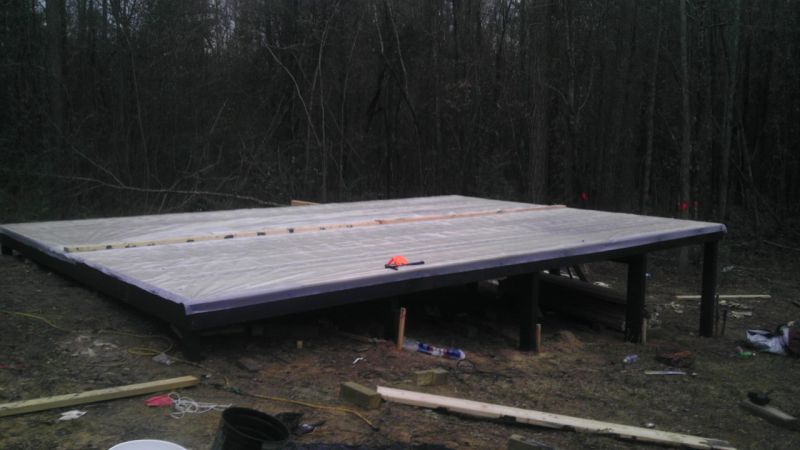

# Posted: 7 Feb 2014 06:05pm - Edited by: redbeard
Well heres a update
redbeard
# Posted: 7 Feb 2014 06:08pm
more

# Posted: 13 Feb 2014 04:25pm
redbeard
Looks like you're well on your way! Do you have any siding on it yet?
After we put all four walls up, and put the roof trusses on, we started covering it with a large tarp. it kept the floor dry and the untreatd walls. Seemed like we had that dang tarp on it forever before we got the metal roof on and sealed up
Just keep working it one day at a time. Before you know it.....you'll be staying overnight!
