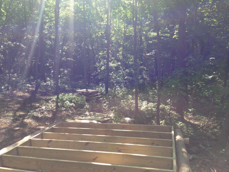

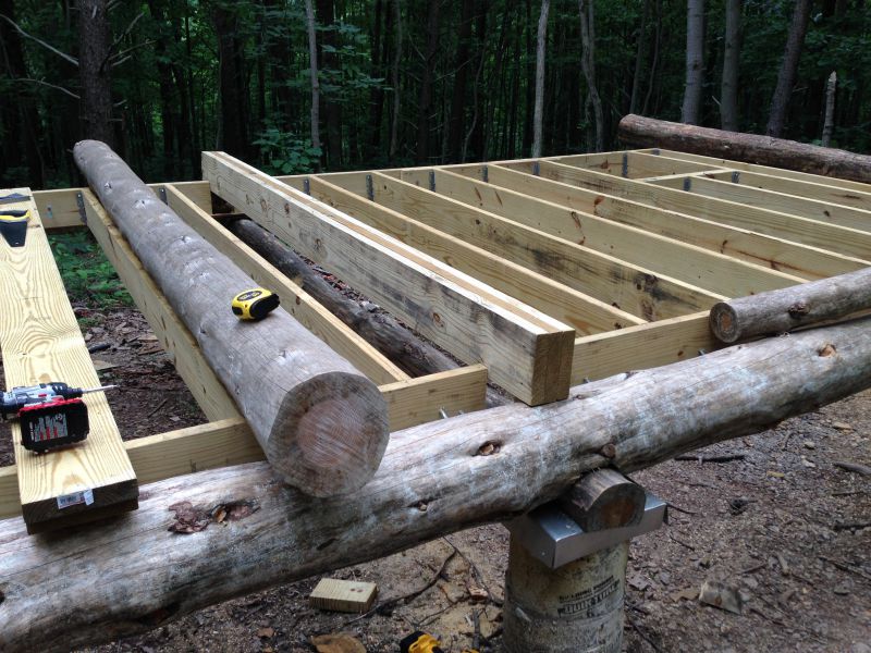

WyattEarp
# Posted: 13 Jun 2014 08:57pm

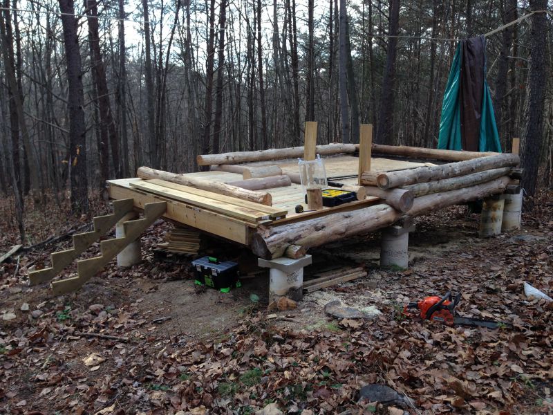

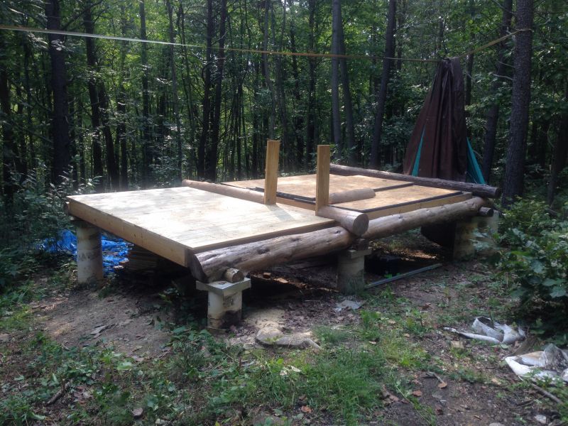

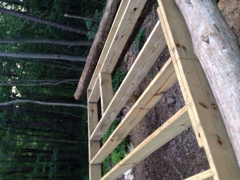

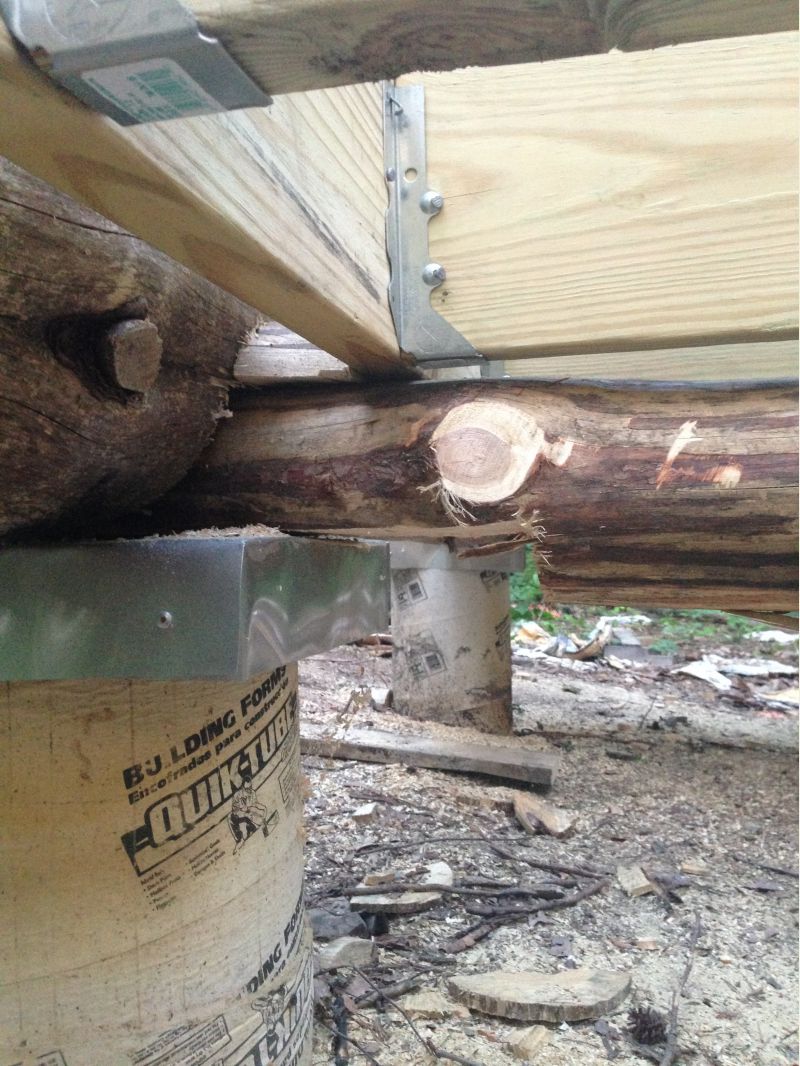

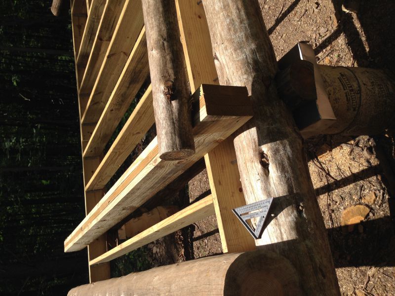

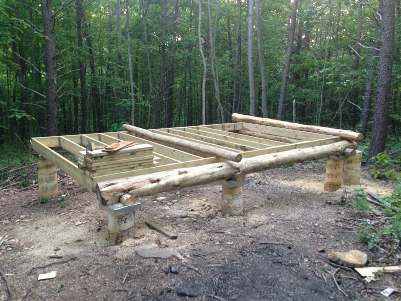

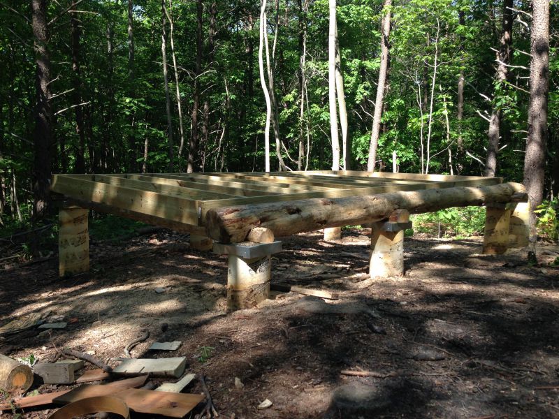

So here's the log pile that needs to grow and the current status of the build. I was originally going to span the floor joists on the insides of the sill logs as I mentioned earlier, but we decided to build a deck inside the sill logs to make things easier.
What we realized after the fact, is when the front wall of the cabin goes up and the door is cut out, the weight from the front wall will put all the load on the log under the sill log, which is spanning the middle 2 piers, since its going to be on top of the sub floor. In 20/20, it was a stupid mistake, but we're working on a way to span a new beam to hold the load. That's where we're at.
Tomorrow, I'm going work on getting some more logs and I look forward for the next phase...
Nirky
# Posted: 13 Jun 2014 10:01pm
I'm looking at the last photo and wondering where you are going to set the logs on the ends...on the rim joists? Then cover the sides of the exposed rim joists up with faux logs?
WyattEarp
# Posted: 13 Jun 2014 10:38pm
I'm thinking we might separate the deck into 2 decks, with a new beam spanning in between.

# Posted: 16 Jun 2014 10:11pm - Edited by: WyattEarp

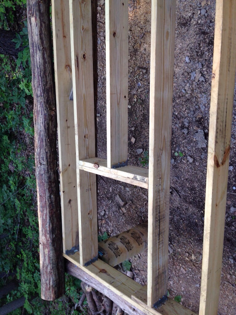

I framed out an area for a trap door in one of the back corners of the subfloor for easy access to storage under the cabin...30x36" opening.

WyattEarp

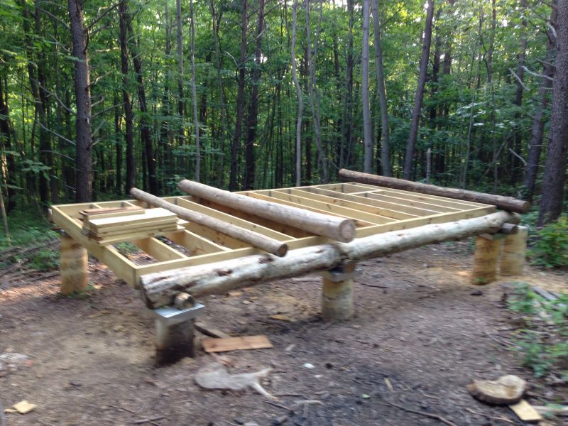

# Posted: 16 Jun 2014 10:23pm
So my buddy came up with a good solution for spanning a new beam between the middle 2 piers to handle the load. We're going to triple stack 2x8s, then notch out to sill logs so the 2x8s will sit flush with the floor. We'll have to cut the rim joists and then use joist hangers to connect each side of the floor to the triple stack. I'm going to be using 5/8" spikes between each joist, securing the rim joists to the sill logs for added support.
Nirky
# Posted: 16 Jun 2014 11:45pm
Spikes would probably work to secure the rim joists to the sill logs, or you could go with 5/8" lag bolts, no pounding.
WyattEarp
# Posted: 17 Jun 2014 07:00am
That's a definite option. I'm going to check lowes after work today.
WyattEarp
# Posted: 17 Jun 2014 09:27am
For the price difference, I think I'm going to stick with the spikes. I paid .60 cents each for the 5/8" x 12" hot dipped spiraled spikes. A 5/8" x 12" hot dipped galvanized lag bolt is $11.20 at lowes.
After I drill with the 12" 5/16" bit, pounding them in isn't bad at all and they still form their own thread in the wood and have good holding power.
WyattEarp
# Posted: 17 Jun 2014 09:33am
Nirky, did you mention you attended a log building class?
Nirky
# Posted: 17 Jun 2014 04:03pm
Yeah if the spikes are the same size and they do pin as well as the lag bolts, no need to spend the extra $$.
Yes I attended the class found at buildloghomes.com in 2005. Highly recommended class, but for what you're doing, it's not necessary. They have a very good forum--a lot of experienced builders who are very helpful answering questions.
WyattEarp
# Posted: 17 Jun 2014 09:52pm
I misspoke earlier. My spikes are 3/8", so I'm going to buy some 5/8" lags. I went to lowes earlier and 5/8" x 8" lags were $4.20ea. I'm going to check another store tomorrow to see if they carry anything longer.
That's cool you attended the class. I'm sure it was a great experience.
I picked up the 3 2x8s earlier for the new beam. I'm looking forward to getting it squared away so I can finally start on the walls.
Nirky
# Posted: 18 Jun 2014 12:13am
The class was an eye opener. I had never before even considered building a shed, let alone a house. They taught me how to do it, and what's more, to do it without a mortgage. Invaluable.
5/8 - 8" long lags should be fine. Except for log shrinkage, there won't be any forces pulling the rim joists away from the log. In your case, what you do want is for the lag bolts to have sufficient sheer strength, because all the weight of the floor will ride on these lag bolts, yes? When I do my 14x14 log cabin, I will have ledger boards for the floor resting on the concrete piers themselves, won't need lag bolts (on the first floor anyways).
WyattEarp
# Posted: 18 Jun 2014 02:03pm
Wow. No mortgage would be a breath of fresh air for sure. All of the weight of the floor will not be directly on the lag bolts, though I am definitely going to be putting plenty of added pins and lags in for peace-of-mind.
Right now the floor is sitting on logs spanning perpendicular to the sill logs. I didn't use large logs for these, becuase I wasn't planning on them bearing any load, (they were just going to help me square up the sill logs over the piers) but after we pinned everything together and started putting the floor in, we realized our mistake. The logs spanning the piers are about 4"x6", since we cut a flat area for them to sit on the piers and the middle log would be bearing the weight of the front wall once the opening for the door is cut out.. Hindsight 20/20...
Before I cut the current rim joists to make space for the new beam, I'm going to go through and add the pins and bolts to secure the floor to the sill logs. Next, the new dimensional beam (triple 2x8) will span the middle 2 piers (above the existing log) and will be the
new load bearing beam for the front wall of the cabin. It's going to be flush with the floor and the floor will be connected to each side of the beam with joist hangers and pins/bolts.
On the rest of the piers, the floor is actually over the piers. This one footer wasn't in the right location.

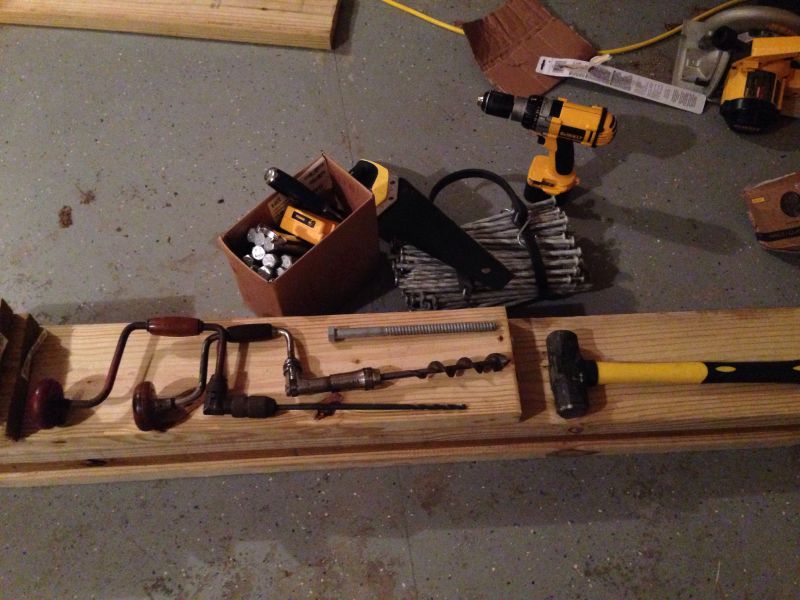

Sayin goodbye to power tools for now. It will make thing easier in this case.
Thanks for the tools Walt!
My grandfathers tools and new fasteners

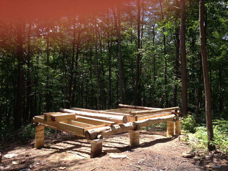

WyattEarp
# Posted: 28 Jun 2014 11:25pm

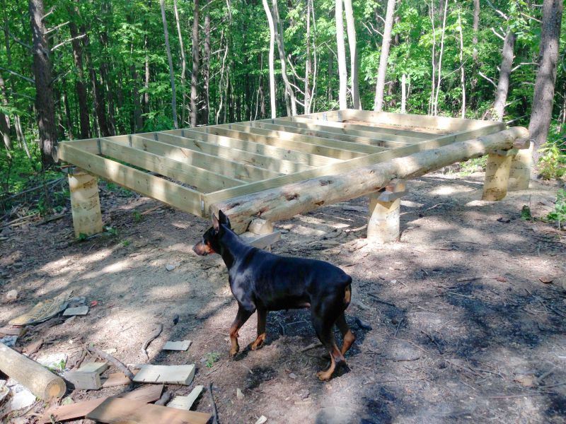

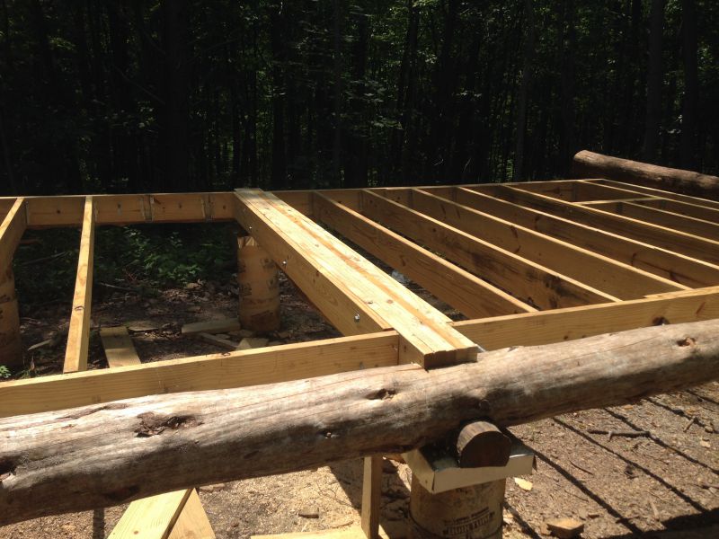

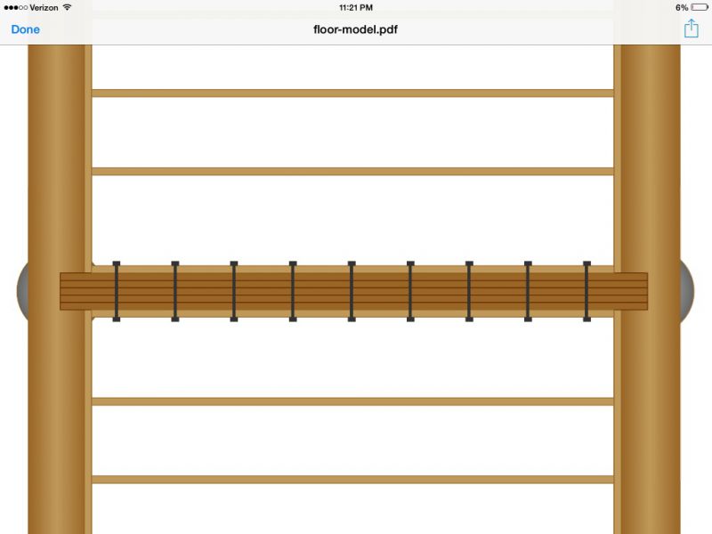

Getting ready to put the new support beam in tomorrow. I decided to stack 5 2x8s together...It will look something like this:
Beam notched in to sill logs over piers
Beam
Beam
Nirky
# Posted: 29 Jun 2014 12:40am
Wouldn't you want that beam to run perpendicular to the floor joists, in center & underneath them for support?
WyattEarp
# Posted: 1 Jul 2014 11:37am - Edited by: WyattEarp
No, I need a beefy structural beam to span the middle 2 piers to support the front wall. I'm sure I'm doing things a little atypical...there's a log in the way to run a perpendicular support beam...
I'll post some pics when I'm done so you can see what I'm talking about.
With the added 30 5/8" x 12" in fasteners, it will be solid. I didn't get to it over the weekend, but I have a nice 5 day weekend, so the beam will be going in Thursday.
WyattEarp
# Posted: 1 Jul 2014 11:45am - Edited by: WyattEarp
WyattEarp
# Posted: 3 Jul 2014 03:55pm - Edited by: WyattEarp

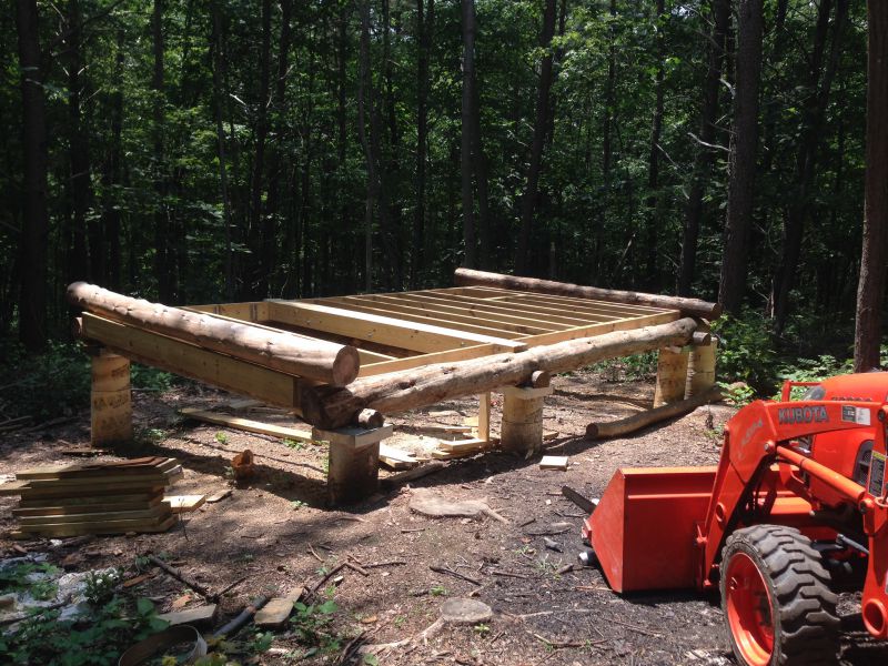

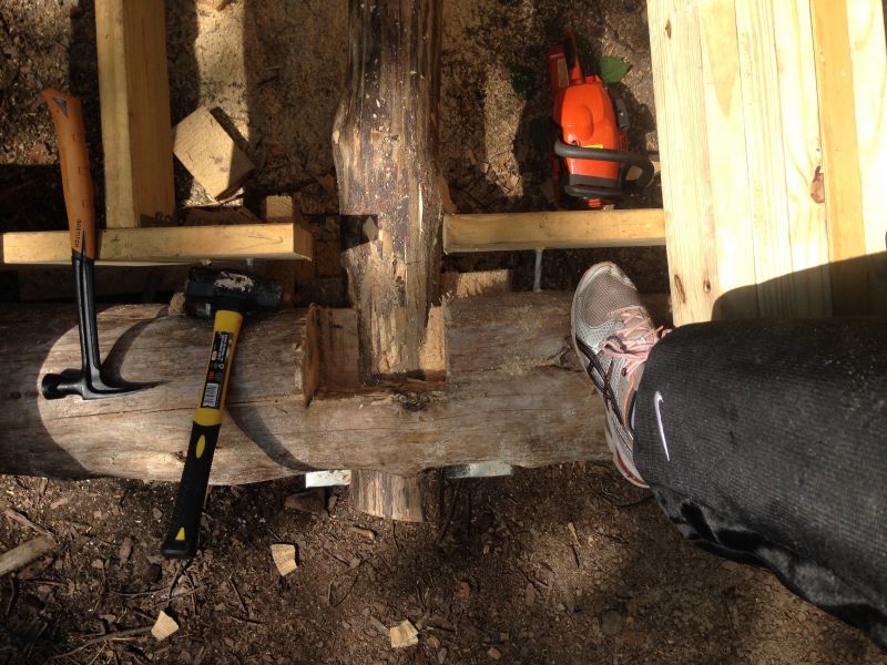

Well the beam went in today. I'm excited to get started on the walls and see some more progress!
Notching the sill logs to set beam in place
A sledgehammer and 20 minutes later

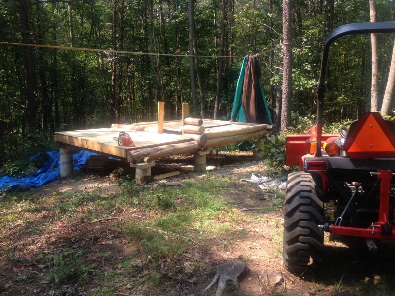

WyattEarp
# Posted: 2 Sep 2015 11:17am
It's been quite a while since I worked on my cabin. It's hard to believe a year has passed and fall is right around the corner again.
I took some time off work for some R&R log cabin building so I could keep the progress moving.

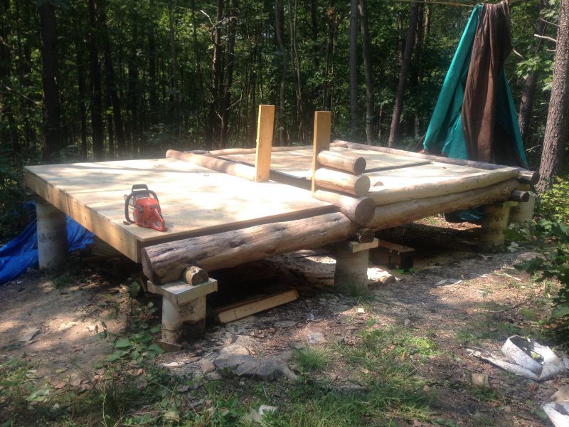

I finished decking the porch and got the osb to the site for the interior sub floor
WyattEarp
# Posted: 2 Sep 2015 11:38am
I've decided on going with a butt and pass method of log construction because of the strength and less settling. And, I've discovered saddle notches aren't my strong suit so it's a win-win (less work)
I put down the first course of logs and leveled them off so I can use the butt and pass method. I also decided on building around my windows and door to get the most out of my available timber. The logs have seasoned now for 2-3 years. They're extremely dry and super light compared to what they used to weigh. I can lift a 10" x12' log, which would've required some help before.
I also picked up window the other day on the side of the road, making the total of one 36" window per wall, plus a small window for the loft.

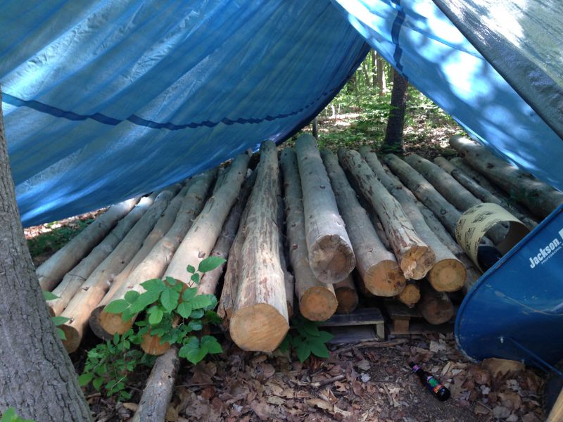

Hey bukhntr, I'm pretty sure I got all the straight pines on my property. Only about 10% of the pines were (semi) straight. I have two more I need to drop for the 18' loft floor beams and ridgepole.
The cut logs have been curing for 2-3 years already and are good to go. I peeled them, put them on skids, sprayed with a product called Tim-bor to prevent fungus and insects and strung a tarp up in some trees to cover them.
Some of the logs did get some fungus before I sprayed them with Tim-bor, so after I get the walls up, I'm going to use deck cleaner to clean them up.

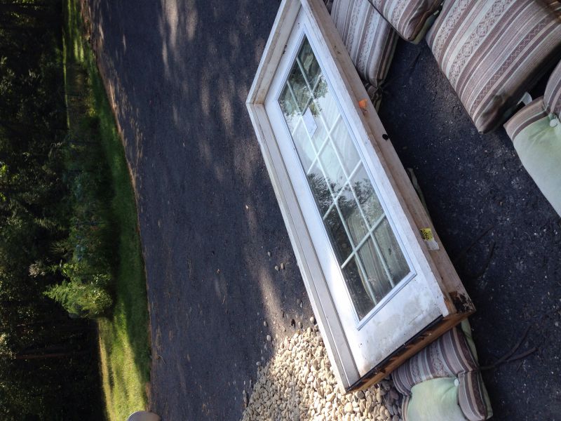

# Posted: 3 Mar 2016 02:49pm

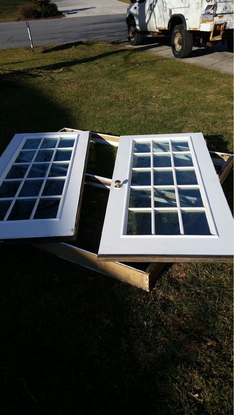

Looks like I'll be selling the door I bought this past summer. My buddy just pulled a nice french door out of a house he was working on and called me to see if I wanted it for my cabin.
Total cost so far for 5 windows and a french door...$0.00
