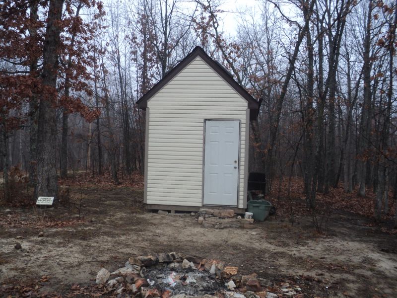

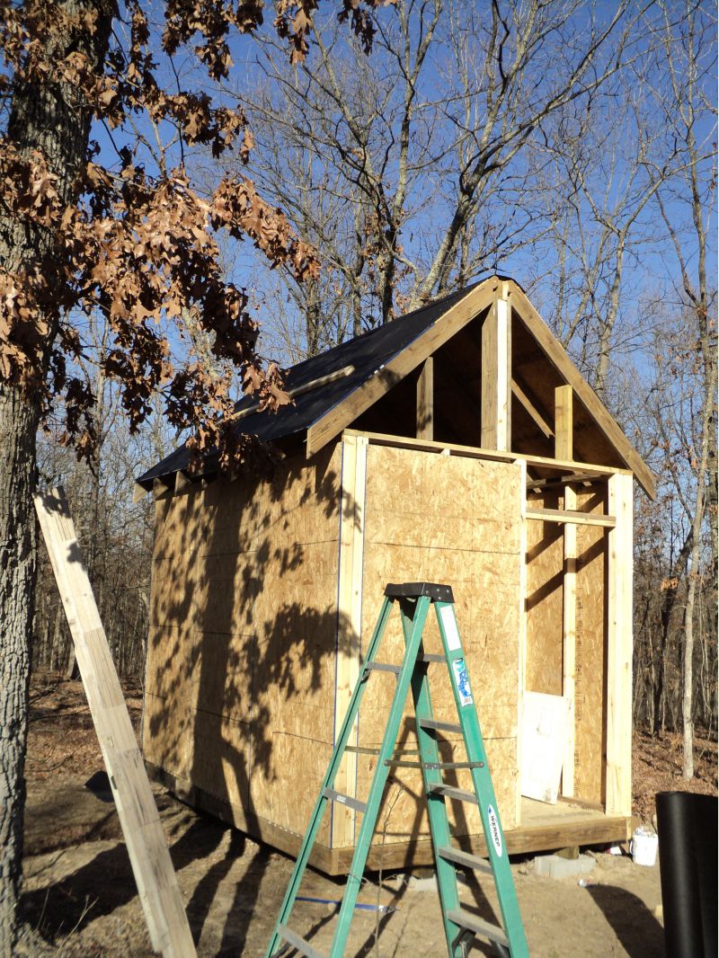

I spent all of 2011 collecting materials from Craigslist free section and rehab stores. I started construction on my 8x12 shed cabin in the spring of 2012. The exterior is done but I don't have the insulation or drywall in yet. I built totally without electric with the exception of the roof rafters I precut at home to save time. It only took 96 man hours after finishing the siding last weekend. Never really did much planning on paper except material lists. I had very little time off this summer so this took all year with many trips. I ended up spending more on gas than materials lol. I wont have a well or electric for some time, I'm sure I don't have to explain why haha. Here are a few pictures please keep in mind the siding color is not the color I'm keeping, I just had to get the thing weather tight and the siding was free.

front view(shell)
front view(shell)
east side of roof
east side of roof

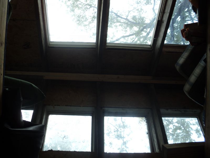

inside view looking up

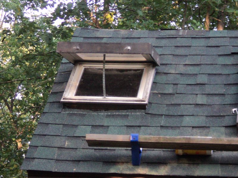

open skylight
open skylight

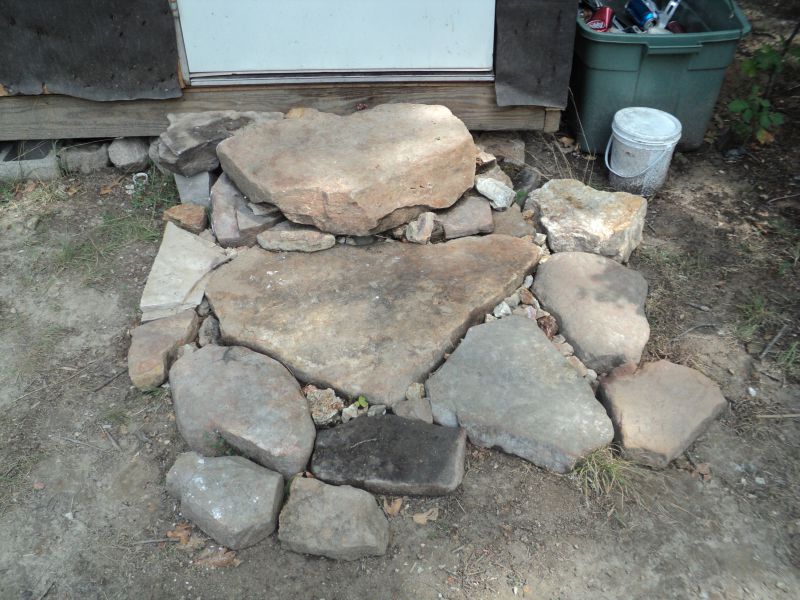

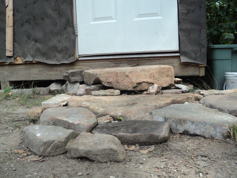

front steps
front steps
front steps
front steps

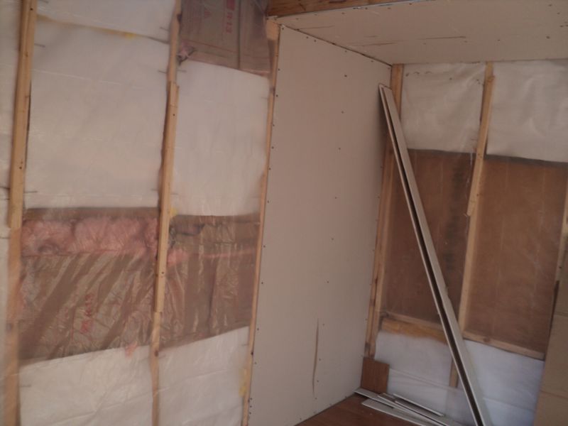

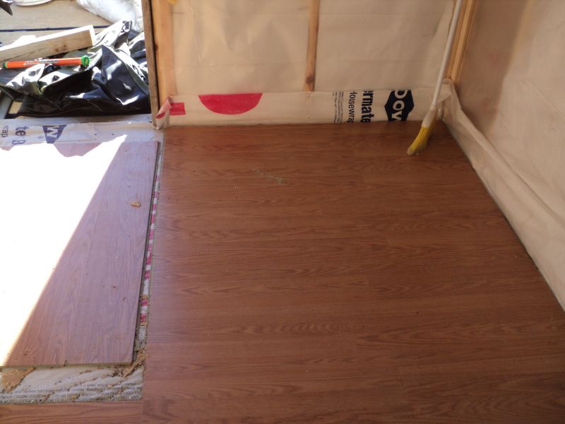

Just a small update with a couple pics. I hope everyone is doing well, I have been enjoying my vacation with lots of work at the property mixed in with some fishing, hiking, or just being lazy around the house here back home. The walls are insulated, a couple pieces of drywall up, Insulation baffles in, and the floor in. Everything was free from CL or friends I used Standard r-13 insulation that was left over from a pole barn. It came in big 7'x20' rolls so i had to cut it down but it was quick and easy. For insulation baffles I used card board sheets from a sam's club. They throw away tons of them every night and are more than happy to give you a few. I left an extra 1 3/4" and just folded it up to give the sheets legs. The free cardboard is actually better than the plastic or styrofoam baffles for many reasons but I wont get into that here. Normally, you would finish the walls before you put the floor in but I get tired of stockpiling materials. I just used a scrap piece of drywall as a spacer and that works. The floor came from my boss's formal dining room. While it is used, it came from a room that sees no foot traffic. I left an area at the door for tile, I'll take care of that this spring. The flooring is much easier to keep clean and it makes it feel more like a living space now. edit: I did buy the plastic vapor barrier from lowes now that I think about it but that stuff is very cheap.
drywall(underside of loft and wall)

floor
floor
