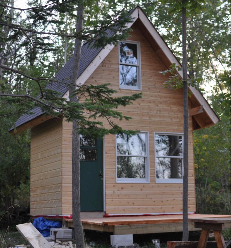

Hello Group
I have enjoyed and benefited from reading this forum. Thanks.
Here is a picture of the status of my small cabin.
It is 8x12 with an 8x12 deck. I just finished the siding.
Next I am working on the interior. .. its not really work...

That right there is what we call, cozy....;)

Welcome! Nice cabin! I agree...most of the time it doesn't feel like work! Congrats!

Nice labor of love you got there.. Would love to see more!

Agreed- what a sweet and cozy cabin! Do you have interior photos?

That thing is really nice looking. Love to see more pics.

What a wonderful small cabin!!! You have done a splendid job.
I hope you continue to enjoy your place/building and look forward to see how you deal with the interior design issues that are a challenge for all of us micro small cabin types.

Great little cabin would love to see some more picks and info on the build and layout inside

Great Job! Like everyone else, would love to see more pics!

Thanks Everyone,
I just got back from a day trip to stain the cedar siding (olympic maximum natural tone cedar).
It is getting a bit cold and wet for staining but it was ok today.
I will take some more pics.
Some details. The inside is still completely rough. I framed it with 2x4 at 16 on center. I had the windows and door for free from relatives (They ended up not using them for some other project). The cabin is pretty tall. 8' ceiling downstairs. Upstairs I put a floor in 8'x8'. The ceiling upstairs is 7'6" just under the ridge beam. The roof is made with
2x8 16 on center. I plan to insulate the roof. I had a post on this site before on that. Still need to decide on whether to use spray foam on top
or fiberglass and deal with vapour barrier. Something to mull over.
The spray foam will likely be too expensive. I did put the vent along the ridge beam with a special strip that matches the shingles.
That is about it, there a similar large window on the other side on the ground floor.
I also have an outhouse with composting toilet with the same siding.

Beautiful little cabin. Can't wait to see it when it is all finished and furnished inside. Congratulations!!

Looks ideal! Would love to see what you do with the inside.

Very cozy cabin. Im going to build my second one about the same, Just 10x10. Do you have any more pictures. Would love to see more
Keep the great work up!

nice cabin. I really like the height.

Hi, how impossibly cute If you have already put in a ridge vent then you don't really need to use spray foam. The nice thing about spray foam is that you don't need any venting or vapour barrier. With the ridge vent you'll need a continuous eave vent and then use cardboard baffles stapled to the underside of the roof sheathing, then batt insulation, then a vapour barrier all sealed and taped, but there must be unobstructed air flow under the sheathing from eave to ridge. Make sure that the insulation goes out over the tops of your walls or you'll have a cold inside corner.
