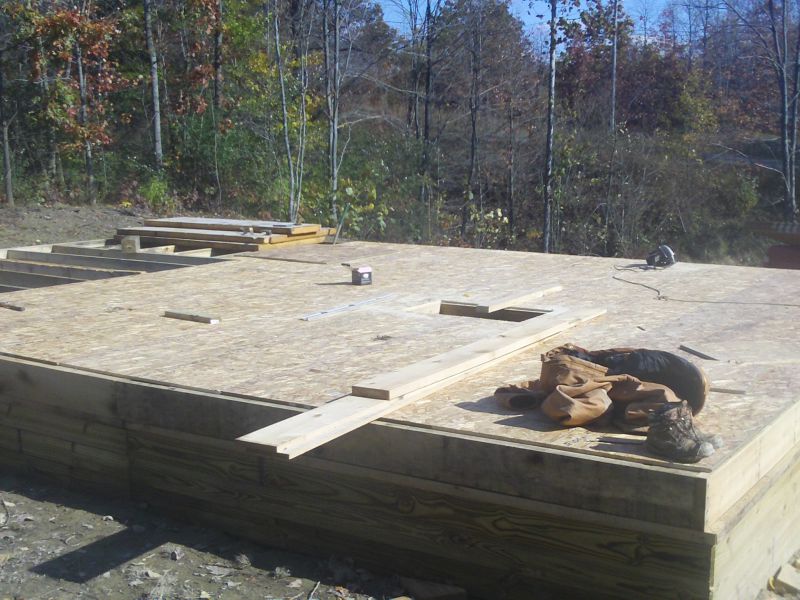

I'm just home from putting in a 12 hour day. Boy, do I hurt! lol. I was at Lowe's just before they opened at 7am to get my flooring. Here are pics of what I did today:
Tim
Lowe's didn't open their doors 'till 7:15am
Flooring started
Flooring started
Getting there!
Getting there!
To protect the floor from delamination untill the roof is on
Tim

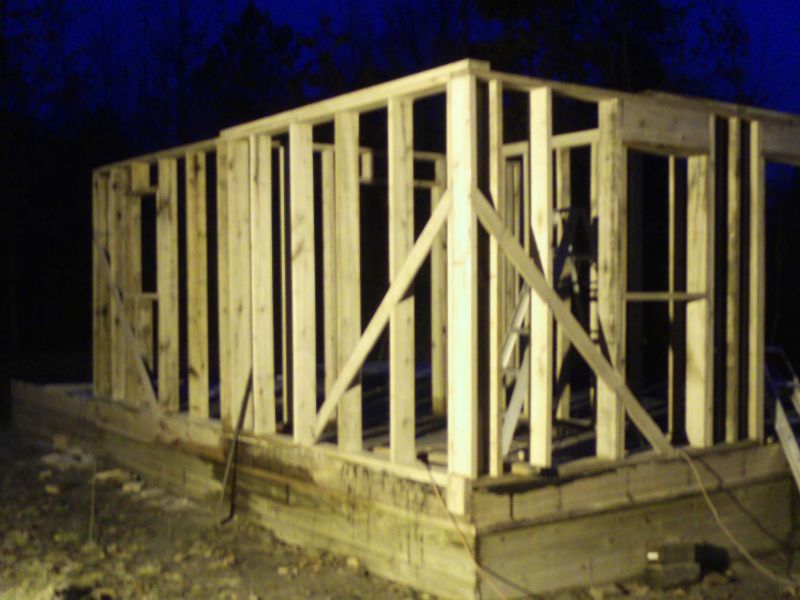

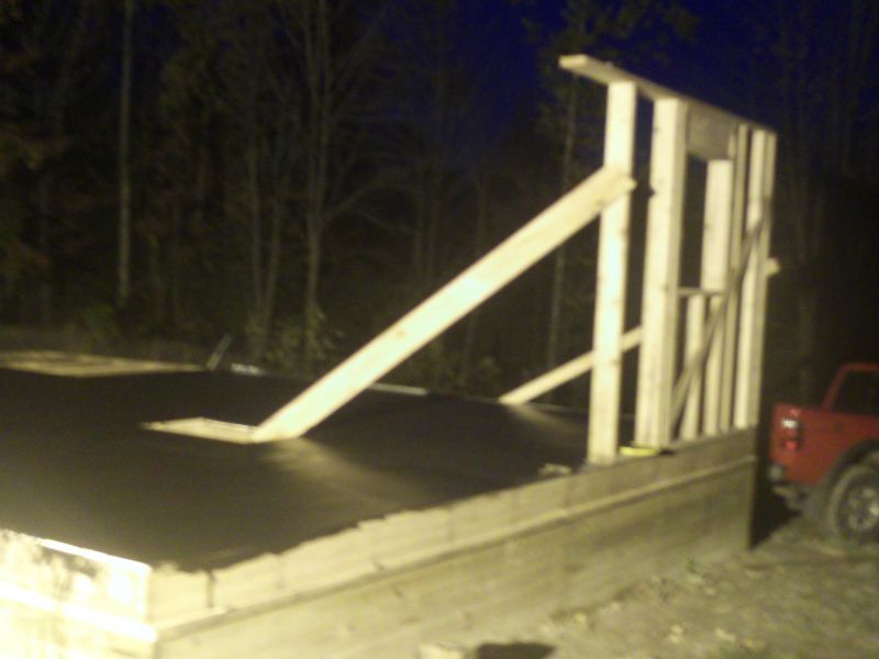

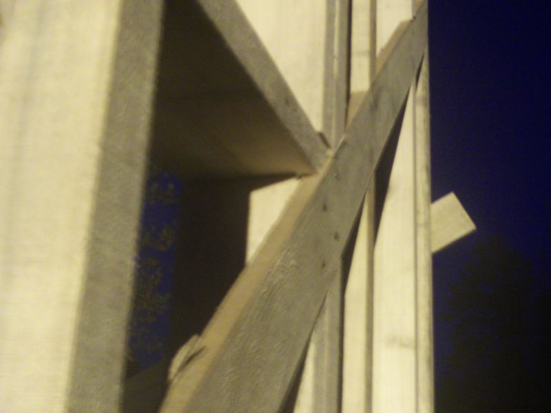

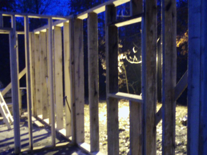

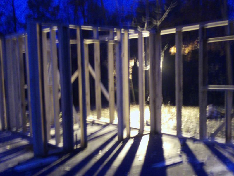

# Posted: 22 Oct 2011 08:13pm
And then................................
Floor done!
Floor done!
A Wall!!!
A Wall!!!
Layed in angle brace
Working with the light and generator

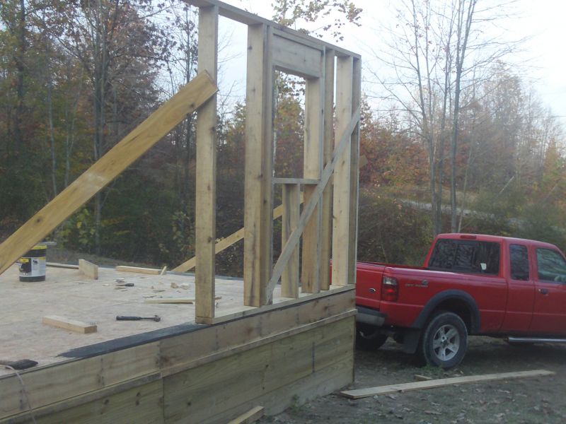

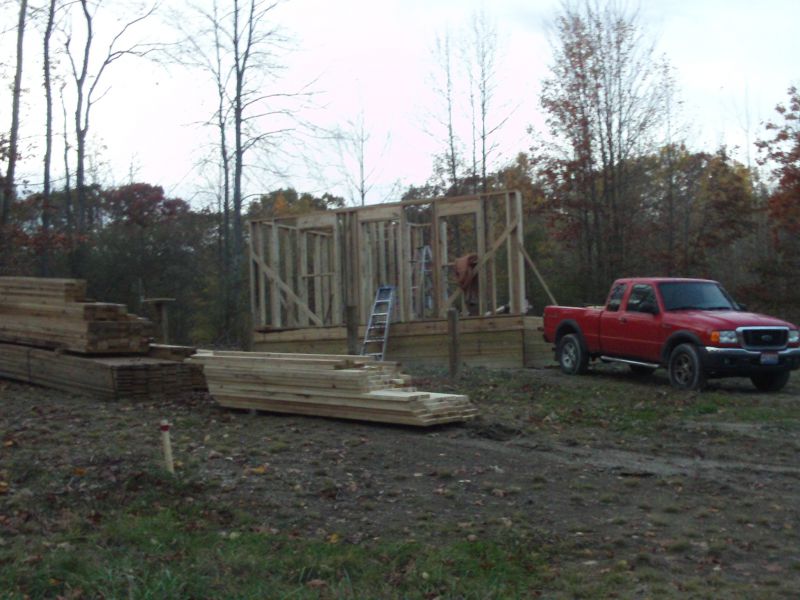

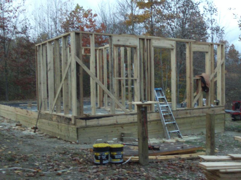

# Posted: 25 Oct 2011 08:29pm
I took a vacation day today. There was a zero percent chance of rain, and it sure was a beautiful day to work!
THE FORMAN!
THE FORMAN!
THE LABORER!
THE LABORER!
IT'S COMING ALONG!
IT'S COMING ALONG!
