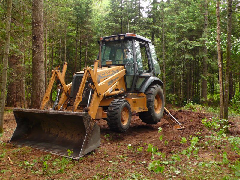

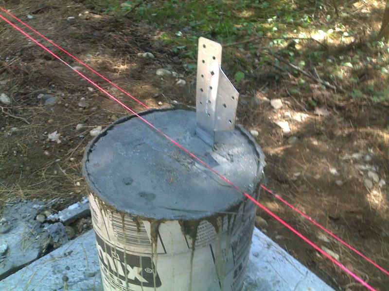

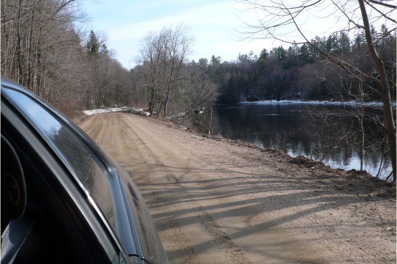

Hey everyone, Just signed up. I'm in progress of starting my cabin. Its on a great piece of land in Quebec Canada, over looking a river. Cleared the trees in the area where the cabin will be built. Last weekend I guy down the river who does canoe trips came by with his backhoe and took out all the tree sumps, best 80$ I've ever spend and bonus he made a hole in the back to put the sumps in and found some gravel. He bought over some of the gravel for my base.

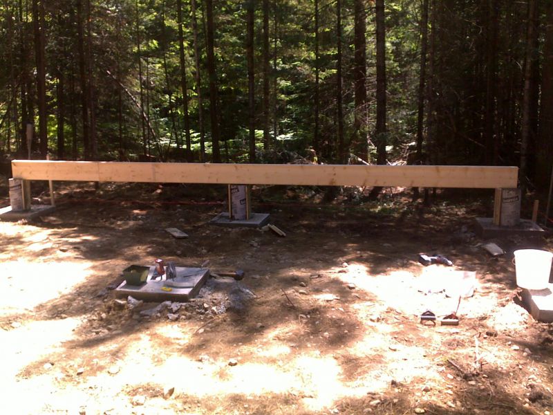

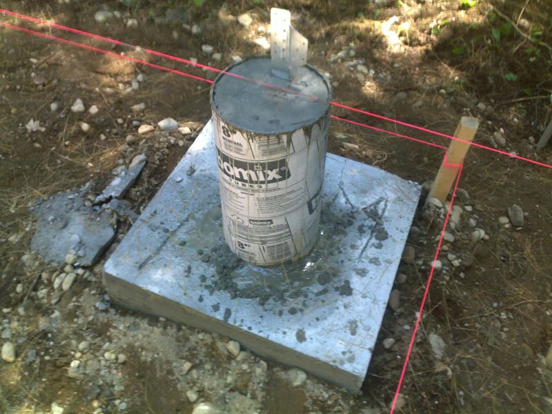

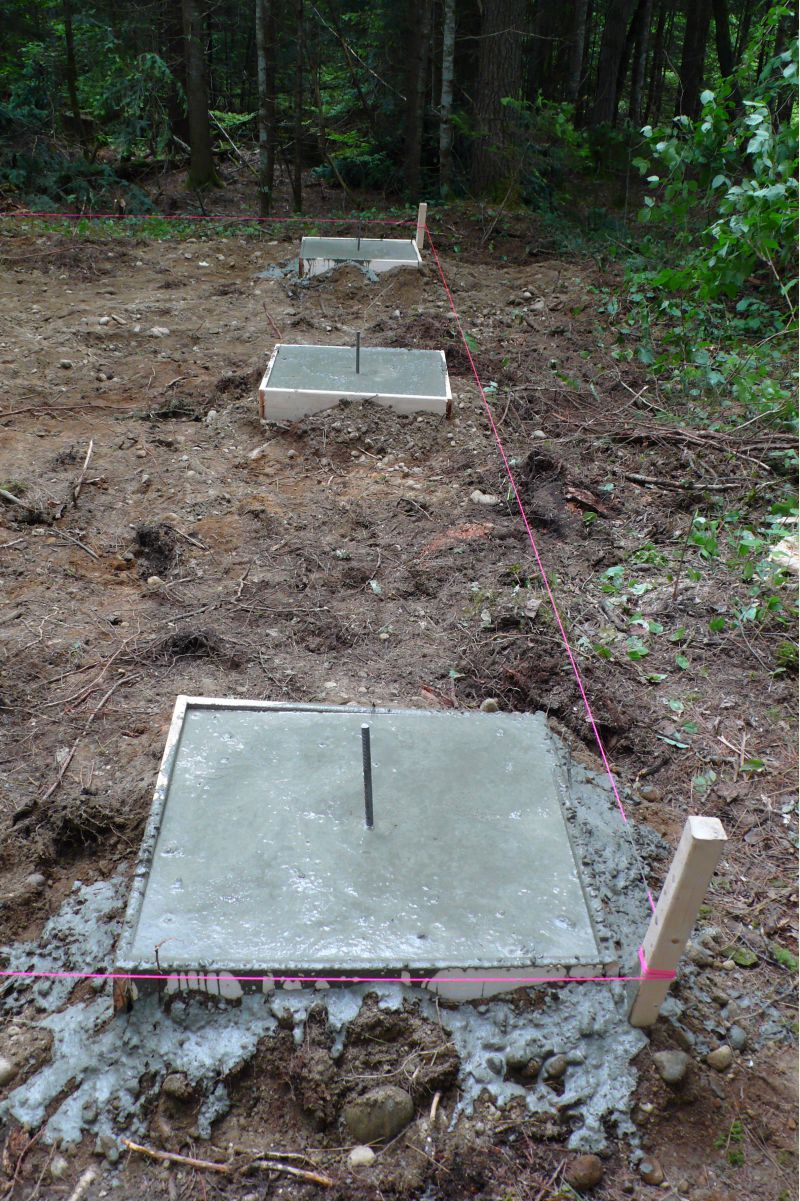

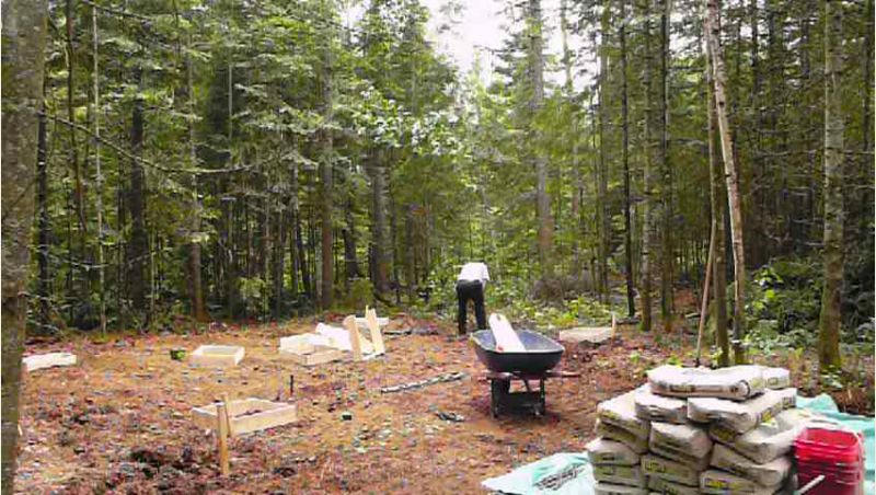

Also that weekend, my dad and me poured all the concrete for the footings. Heading up there this weekend with some friends and pouring the concrete for the piers and building the built up beams. Perhaps if the concrete is dry the next day we'll start the ground floor.
Should I make my walls 16" or 24" apart? and 2x6 or 2x4, I plan on putting a wood stove for the winter, and it would get very cold up there. Also does anyone know where to get the metal roof? Having trouble finding places who sell it. Either in Ottawa area or pembroke

Welcome mark fellow canadain here .If there are no code issues i would go with 2x6 on 24 in. centers that would be the warmest. if you plan on using real wood panaling on the inside that will be great .As for the steel ask for barn roofing steel 28 guage that's what most fooks use ,should be able to order any colour any length at any lumber store near Ottawa ! goog luck with your build. JUST,,--ONT.

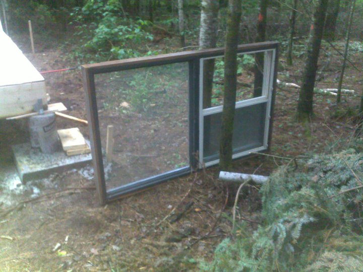

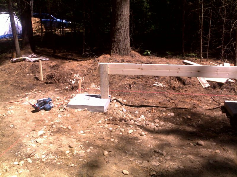

Here are some more pictures from last weekend. This weekend is the base floor. P1070663.JPG

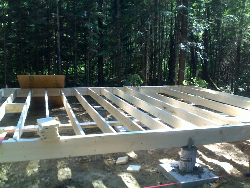

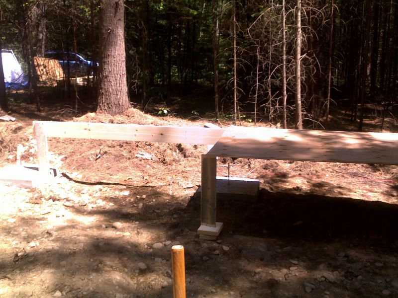

# Posted: 20 Jun 2011 09:17am

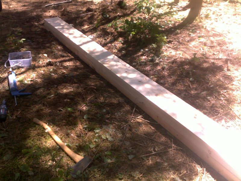

We got all 9 piers in, two 2x10 by 20' built-up beams on each end. Then a 2x8 by 20' in the middle, just under the floor joints. I got all the blocking in and ready to screw down the floor next weekend and start my walls. 06182011178.jpg

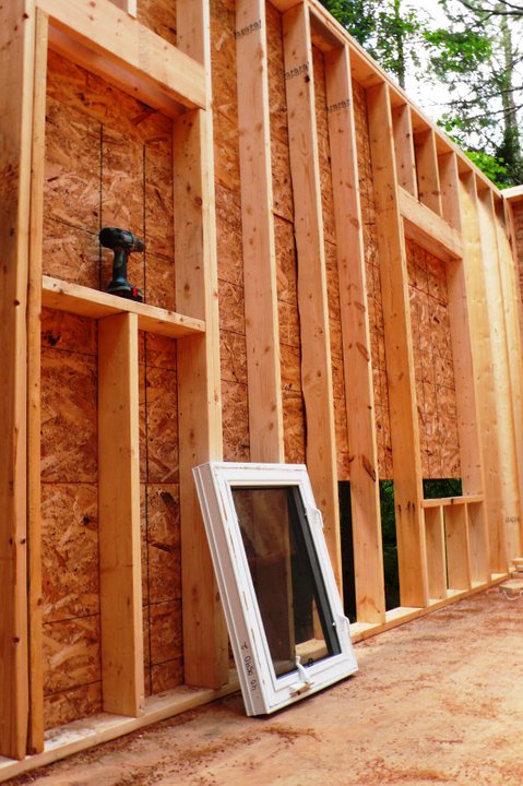

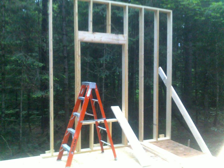

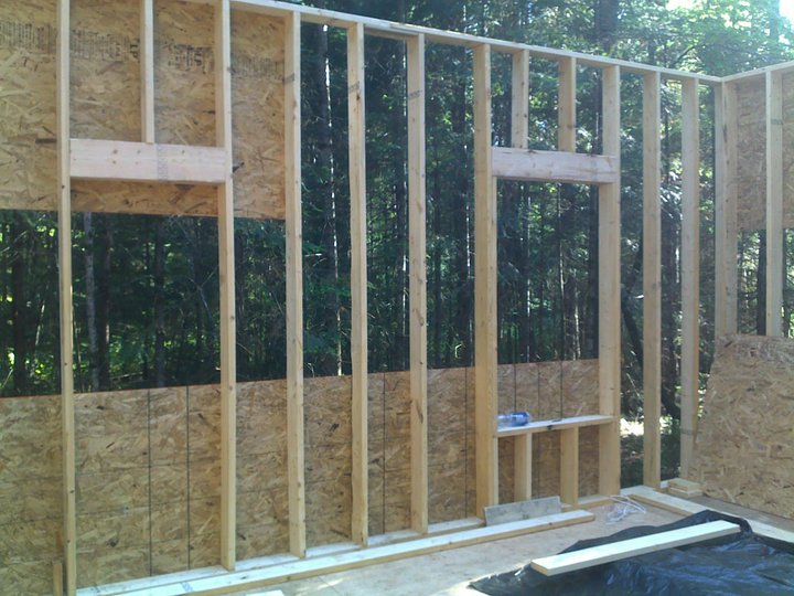

Okay, i'm looking for some advice. Im finishing up my wall this weekend and going to start my walls. Now for my headers above the windows, what should I use? the walls are going to be 2x6 10'. I have 5 windows that are roughly 4'6" high by 3'6" wide. Also should the header be at the top of the wall or just above where the window will go?
Thanks
# Posted: 21 Jun 2011 02:16pm
2x6 just above the window you will need some2x2 to go between the 2 2x6 headers and a jack stud on eather side of the opening that carry's all the way down to the bottom plate, should have some insulation to go in between the headers when they are beeing built as that area will be inaccessable later .

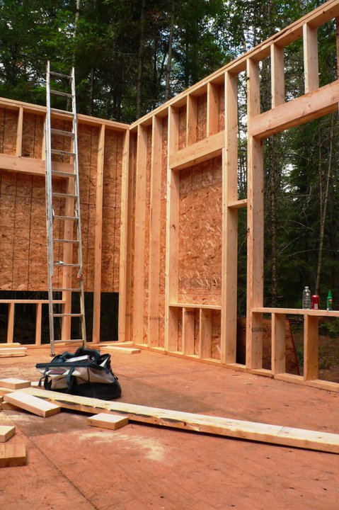

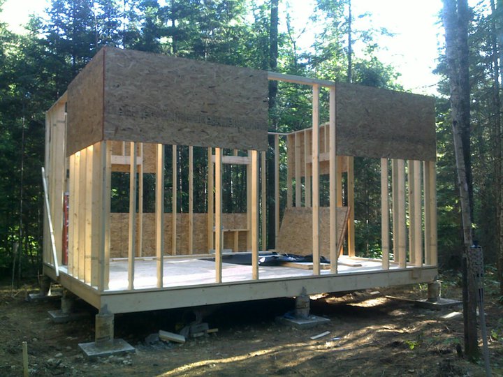

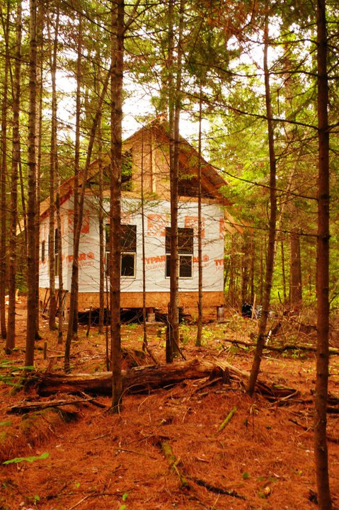

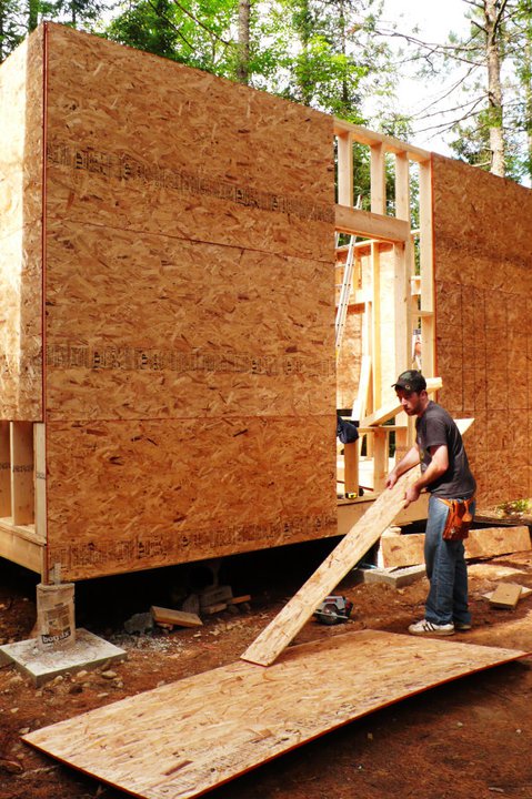

Hey everyone. So I got up my 4 walls this weekend with my dad. I also finished my subfloor of course. the walls are 10 feet high and my loft will have 2 ft of that wall before the roof slopes in. going to be very nice. Heres a picture of 1/6 big windows I got. Got them for 20$ each. Plus I bought a small bathroom and kitchen window for 80$. So for all my windows I spent 200$. Crazy eh!!

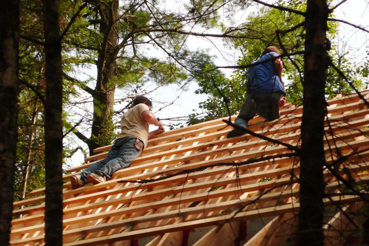

Hey everyone, just thought I'd stop in can give a update. I have all the walls framed and ready for the windows and door to go in as well as 95% of the sheeting is up. Also have to cut the holes in the sheeting for the windows.
I bought a 85' suzuki quadsport lt230 from a neighbour over the weekend, run's great and the funny thing is its one year older than me haha. Plus its great to get around there. Also if my car every dies on me at least I have a secondly way to get help or wtv.
Enjoy the picture!
Starting roof this weekend!!! woot woot

Mark---your camp looks great........... you going with 2 x 6 rafters ( 16 inch center) , 2 x 4 strips for your metal on 2ft centers??? PS---like the 85 quadsport....... i have a ole 91 yamaha timberwolf i keep at camp, those old ones run for ever!!!! Just put stabil in it off season.

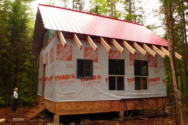

# Posted: 7 Oct 2011 11:36am
Its going great. Took a bit of time off from building, but all the windows/roof/door are installed. Going up this weekend to install my compost toliet I bought 2 months ago and to put in some insulation. Its getting very cold up there.

# Posted: 7 Oct 2011 11:39am

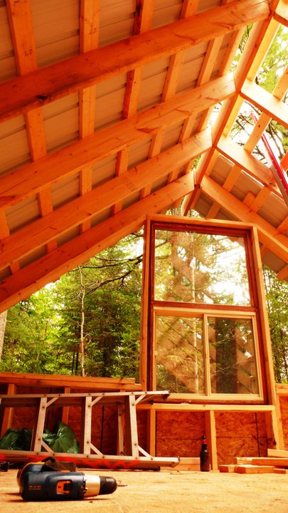

Here's some more pictures. In the spring im going to buy more tin and have more of a overhang. About 2 more feet. Focus on getting the inside insulated now and finding a wood stove....winters coming!

Looks great- I like the color of the roof metal. What are you going to do for insulating the roof? How about the floor?

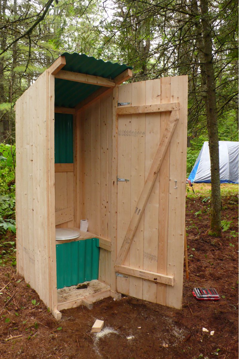

Here's some pictures of the compost toilet I bought. Attached file: t3.bmp |  t2.jpg

# Posted: 12 Oct 2011 09:22am
Its okay,
my cabin is 16 x 20 feet. with a loft. I made my walls 10 feet high so the loft would have a lot of room.
It is prob the easier to make your own trusses and much much cheaper.
The way I did mine was I built the center beam. And then I bought 2x8's by 16' long to be my rafters. I set one up at the end and marked the angle to cut at the top and I made a bird nest cut where the rafter touchs the top of the wall. That way the rafter would sit on the wall. Once I made the right cuts. I used the first one to mark the rest and then cut them all. And then placed them.
