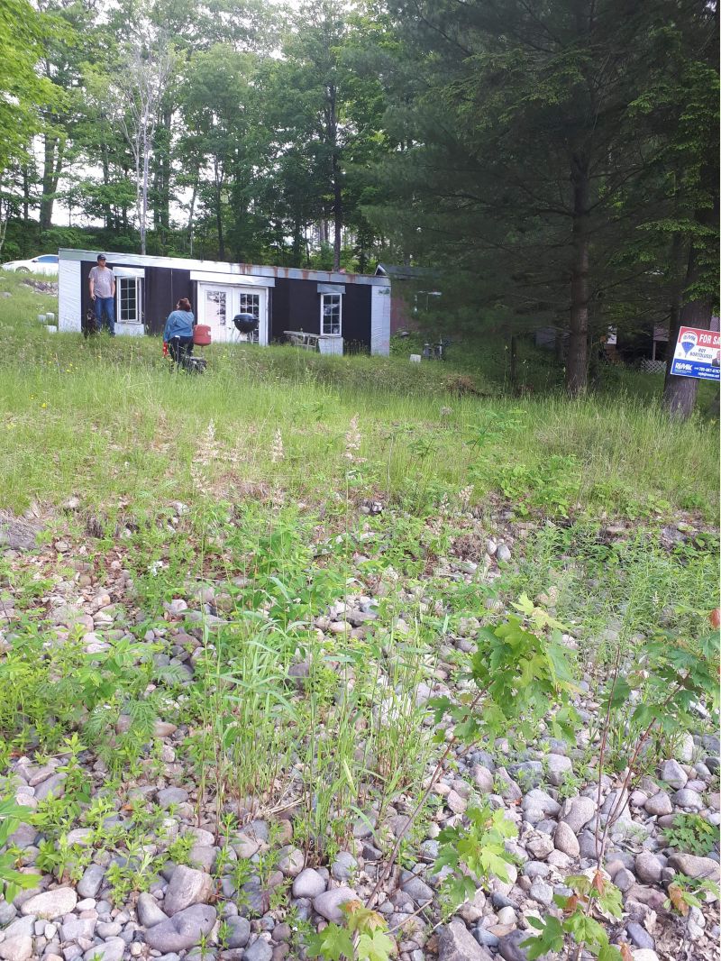

Hey everyone,
My wife and I recently purchased some waterfront property in an organized township in Northen Ontario. I've been researching and reading through the forum for many hours now and have gained a lot of knowledge and some great ideas for what we want to do with our property.
A few things I'm curious about, that I couldn't find an answer to.
We do have a 30x30 block foundation in place from the previous owner. It does look like it is well built, but unfortunately it doesnt have a building permit at all, and therefore no stamped plans from an engineer or anything like that. Would it make sense to have the building inspector come out to inspect it before we continue with any other planning? Or would we need to get an engineer out and draw up a plan for it?
Another thing we are finding confusing is a septic system. The property is zoned recreational waterfront right now, but it seems as tho we still need to have a septic permit in order to get a building permit. But the property is too small to have a traditional septic system. Ideally we would just have a composting toilet because we dont want to have to worry about water supply right yet, but I cant find a definitive answer if there are any available that meet the building code requirements.
Any tips or advice is much appreciated, and we look forward to getting our project underway
