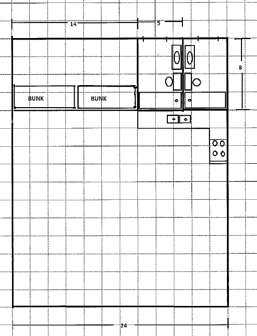

pondjumpr
# Posted: 11 Mar 2019 04:40pm - Edited by: pondjumpr
This is a rough sketch but may give an idea of what we are thinking of doing. All the cabins will be within 50-100 feet from this structure is possible.
central area
central area
# Posted: 11 Mar 2019 07:13pm
If you are accessing the corner bathroom from the exterior I'm guessing that this one will also be for people washing off after outdoor activities. To make the room more versatile I would deepen the room to 10' and add a wall between the tub and toilet (and also turn the tub into a shower about 42" wide). This way someone could still use the toilet or sink while someone is showering.
The extra 2' in width will also give you more space in the bunk room. Most single beds are 40" wide and by the time you deduct for walls thicknesses you'll only have about 4' next to the beds to move around in.
