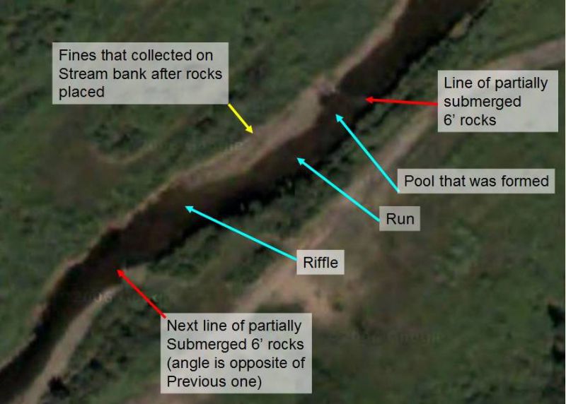

Years ago I got involved in stream restoration projects with Dept of Fisheries and Oceans here in the Maritimes. They went to streams that had been significantly negatively impacted by man - lots of causes - and were restoring them. You probably can find info on line about the process thru google. The basic premise was to restore the natural pattern to the watercourses which is pool, run, riffle. As a general rule of thumb that pattern repeats itself a distance down the watercourse every three times the stream's width. Narrower rivers obviously have shorter distances between pools. I am not sure of the whole process of this discovery unfolded, but it started with the US Engr Corp of Engineers and their work on the Mississippi River. They came to the realization that all the dredging etc is pointless unless you work with mother nature. Water is an amazing force - it may not seem that way on a day to day basis looking at a river or a stream, but you have to think of it over the course of a year - spring and fall surges in run offs, big storms, ice, etc, etc. I saw pools created on streams that ranged from 4' wide to 35' wide. In the case of smaller stream logs were placed across the stream at appropriately calculated angles - in the case of the 35' stream we dug in 6' boulders into the stream bed. The changes within a year were amazing. Streams that were for all intensive purposes dead - shallow throughout and warm water - had pools, riffles and runs. The stream bed - rock, sand, etc had sorted it self out and the most amazing thing was that there were pools 5' deep were the water had been less than 1' deep! And the streams again meandered - the pile up of finer material on the banks was amazing too and was part of the process of the stream sorting itself out. The trout loved it! So it is possible however it is scientific - if you don't do it properly you will create a lot of issues. And then there is permitting. If you did that without a permit in Canada you would be charged and taken to court! And there would be no defense that would save your butt! You may want to check with your state or provincial wildlife branch or in Canada Dept of Fisheries and Oceans - don't have a clue who would be the national authority for something like this in the US. I have some pics at work and if I remember I will post some. The lesson I learned from this work is that you have to work with water not against it. It will eventually take back anything that doesn't fit into it's natural system and is evident during most springs of the year!

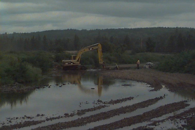

The picture is one of the sites we worked on - satellite imagery is not great but you can make some of the stuff in the stream out. Prior to the work we did this stream was absolutely straight and only six inches deep. You can see that the meander is coming back and a "beach" of sorts was formed a little down stream of the rock sill and pool that was created. We used a tracked excavator, bulldozers and ten tonne dump trucks to do this work. Pretty amazing the power of water! But know you must work with it and if you try and control it you will get nothing but grief!

I think the key was that the biologists looked at natural processes and worked with it and reintroduced it. The thing that amazed me was the pools created right behind either the logs or rock walls - the water flowing over it created the pools - pretty amazing to see a 5' deep pool within a year caused by water dropping 6". Working with nature rather than trying to control it gives such good results - worth thinking that way when it come to building too.

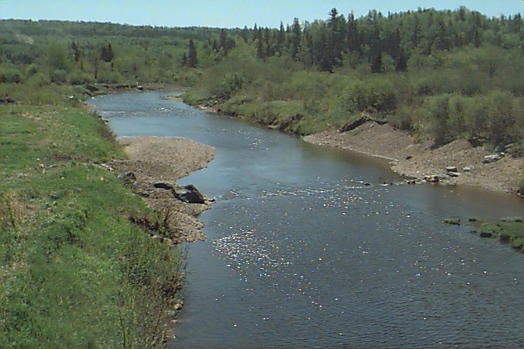

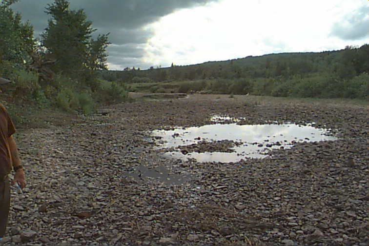

# Posted: 14 Feb 2014 10:40am
Some pics of the stream shown in the previous satelite image during installation of the rocks and the year after. It was a pretty amazing transformation! image06.jpg
