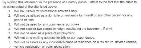

Hello all, im new here, I have a question for people who have built in pa. I am in the planning stages of a cabin in the woods for myself and my wife. we are trying to build it with only us, and cash on hand (no loans and we arnt wealthy), I have been able to convince her that we do or dont need certain things, so that it falls under the category of recreational cabin in pa and therefor avoids building permits. My one question that I cant find is can we hook this up to power and still be classified as recreational, or by hooking into the power utility do we then jump out of that class?
PA_Bound
# Posted: 15 Dec 2012 06:25pm
Yes... the PA Recreational Cabin Affadavit does not restrict attachment to any utilities. Below is a .jpg of the restrictions noted on my notarized RCA.
RCA restrictions
RCA restrictions

That is accurate, although we were required to get a building permit from the township after the affidavit was submitted. They did not require plans though, which was interesting. The only inspections required were electrical as we hooked up to power - inspection of connection by power company, and pre-close-in inspection by township.
