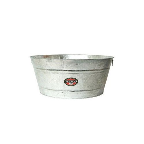

Behrens has a 35 gallon galvanized tub that's just a bit smaller than your kiddie pool. It's what I plan on using for my shower pan, although I will be plumbing it in. Amazon has them for $47 delivered.
