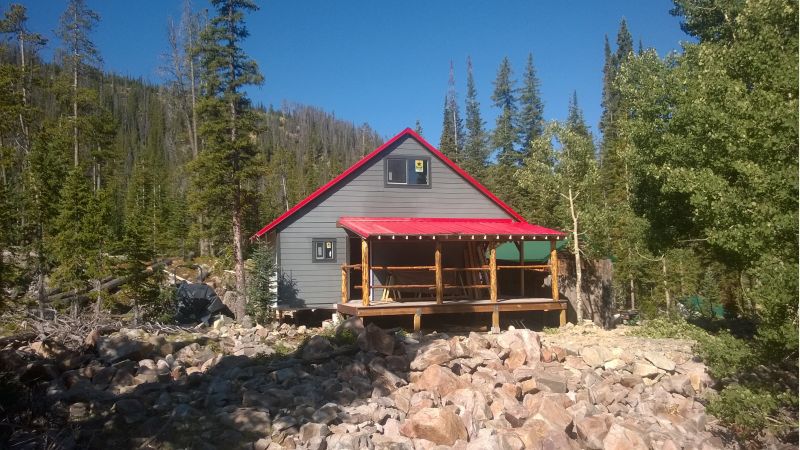

I have a natural spring on the side of my mountain that flows into a 2500 gallon tank buried up there. It's just gravity fed to my cabin and produces around 80psi. I have to regulate the pressure down before it enters the cabin. The only maintenance is walking the water line every spring to look for leaks. The line is above ground and we get so much snow that it insulates the line all winter.
You can see the mountain in the background.
# Posted: 14 Aug 2020 10:45pm
^ beautiful cabin setting. I can see why pipe is on top of ground.
# Posted: 15 Aug 2020 08:31am
Man sno that is some rocky "soil"

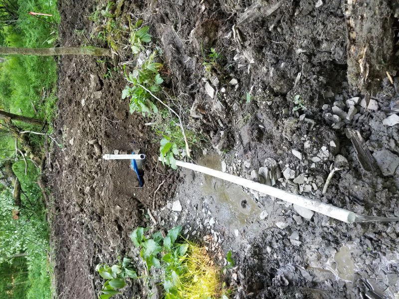

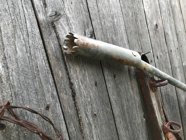

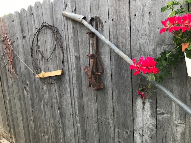

Hello neb, I need to finish mine. I have two inch pipe. Started with a post driver but not happening 20 ‘. If you used a jackhammer did you make an attachment? And what did it look like. Or anyone? I need some designs to build one. Thanks man i
# Posted: 17 Aug 2020 08:11am - Edited by: neb
^ No jack hammer. I dug a 6 inch hole down ~3 foot. Then I made an auger and attached it to a 10 foot 3/4 inch light wall conduit. The auger is a 1 foot 1.75 inch piece of pipe that I can easily dump when pulled back up by tapping the auger or sticking a small rod in the end of the auger head. I used a vise grip to turn the auger pipe to fill the head. Then pulled up and dumped. It was 5 to 6 inch depth each time I dumped. I did this process till I reached 10 feet. Then I had a piece of sucker rod that was 15 feet long which I put a sharp point on the end and I broke through the hard pan. Then I started to drive my sand point which was not hard at all because I was down about 13 feet so the last 8 I didn't have all that resistance of all that earth to drive through. Here is a picture of the wobble head auger that is attached with a bolt and the 10 foot 3/4 inch pipe.
I sand point I used is 1 1/4 inch galvanized pipe so it fit in hole to the 13 foot mark. To get to ~13 feet took just a couple of hours.

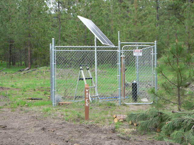

I had a well drilled and installed a solar livestock well.
I turn on a switch, water runs out about 2 gallons a minute. Well is 178 feet deep, static water level is 100 feet.
# Posted: 17 Aug 2020 10:25pm
^ mine is producing 5 gallons every 39 minutes. I have been very happy and have plenty of water at a depth of 21 feet to the bottom of the sand point.

# Posted: 17 Aug 2020 10:34pm
Quoting: toyota_mdt_tech
Why the chain link?
