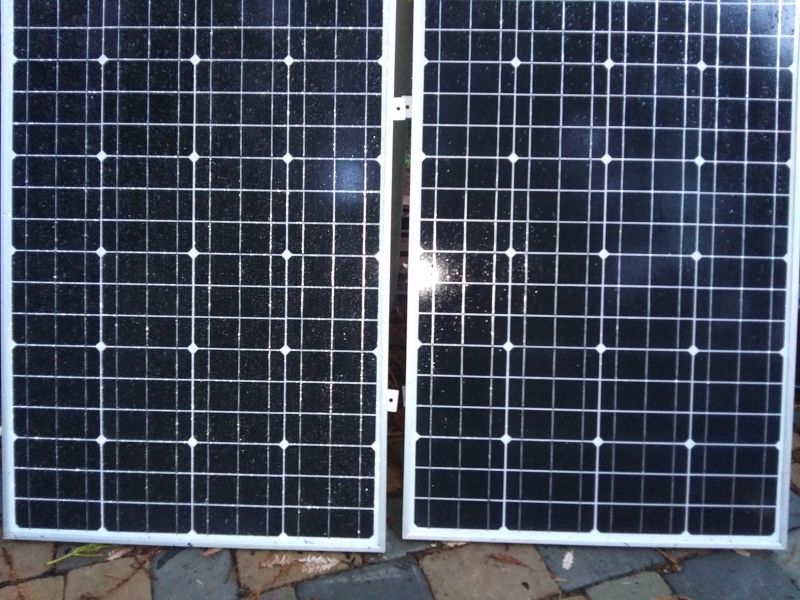

I've concluded my big panel washing test, at least for now. Yesterday I just sprayed them off with the garden sprayer, which is about as strong as peeing on them. But it did up the amps from 2.3-2.4 to 2.5-2.6. This morning I could see not much dirt had been removed, so I got out the soap and sponge. That really helped, sitting at 3.6 now. Hard to gauge because of altering shade, time of day but it does jibe with what I noticed last time it rained. A marked improvement, I'm happy.
# Posted: 2 Mar 2021 05:06pm - Edited by: gcrank1
Well, If you are at all like me (old guy) you couldnt pee that high or long enough.......I prefer the garden sprayer for that kind of stuff  Some of the vanny's even use em for shower units by replacing the wand with a kitchen sink hose/spray head. Works pretty good for spraying off muddy boots too.
# Posted: 4 Mar 2021 09:23am
Went up on my shop roof to steal a few panels for my cabin yesterday, those panels were really dirty, no surprise considering the tree canopy above. Now I'm thinking about some kind of slippery coating, like Rainx or that new ceramic wax I put on my truck. That stuff is so slippery I can hardly set anything on the hood without it sliding off. Rain too slides off.
Don't want to upset the performance of the panels though. Can't imagine it would but it's still magic to me how those things work.

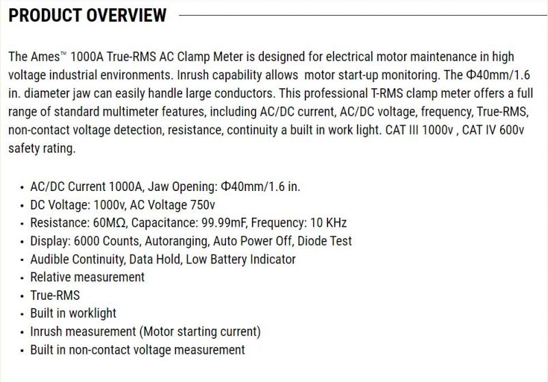

Incidentally, I splurged the other day and bought a non-contact DVM, $100, hoping I could measure panel or array voltage easily to see what's doing what. No luck so far. It's supposed to measure both DC voltage and amperage but I have gotten nothing either at the panel wiring nor the SCC to battery. I did put it on my truck, started it up and turned on the lights and heater, got 2 amps at the battery cable.
It might be just too low for this thing, or it might need bare wire to read (although the Donk thing doesn't). Going to play around a little more and hope to get something out of it.
Here is what I got: https://www.harborfreight.com/cm1000a-1000a-t-rms-acdc-clamp-meter-64017.html
Owners Manual: https://manuals.harborfreight.com/manuals/64000-64999/64017.pdf

The clamp part of a clamp meter only reads amps, at least that has been the case for any I have used. It may be able to sense the presence of voltage in a non-contact method but I don't understand how it could read the actual voltage.
# Posted: 4 Mar 2021 12:23pm
Yes it says to read volts you hold the wire to the probe at the top of the clamp, on the outside. Maybe that's AC only. But I'm still getting no amps on the solar, and on the car I think it must have been charging more than 2 amps.

Quoting: paulz It would be difficult to detect on one panel out of 15.
I was just thinking of a visual test. Treat one panel and after a month or so see if you can see any difference in the amount of dirt that is on the treated panel. Or the half panel. I don't think anyone could argue that dirt on a panel does not matter. Anything that blocks sunlight from striking the silicon layer cuts output. If the treated panels remain cleaner, then maybe it could be worth the effort and cost to treat them. Maybe in a marginal production area likeyours.

Quoting: ICC was just thinking of a visual test. Treat one panel and after a month or so see if you can see any difference in the amount of dirt that is on the treated panel.
Oh, yeah I can do that, and it's supposed to rain Saturday. Stand by.
I was just concerned that it may somehow inhibit how the panels absorb light.

Are my panels actually glass? The way they've taken a bending and beating moving them around I thought they were some kind of plastic.
Anyway yesterday I put my hi falootin ceramic car wax on one of these small panels, before it rained last night. This morning I can't see any difference in water retention. I'm surprised, as like my truck, it's much smoother to run a hand over compared to the other panel.
Oh well, saves me a bunch of work..

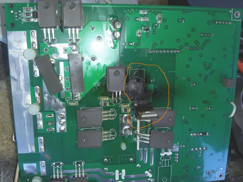

Darn, looks like my Renogy Rover CC bit the dust. I was outside the cabin when my wife yelled SMOKE! Gone when I got there but no charge out of it. Now it's just displaying gibberish.
I checked and the PV voltage was just over 100, which is odd because it usually shows 50-70. I really think the rain does something.. It's supposed to have PV over voltage protection and shut down until voltage drops. So maybe that was the problem, or maybe it's true about Renogy..
Anyway time for a new CC. Just when things were starting to look promising. At least I was here when it happened and no fire.

I took the smoked Renogy CC apart, wasn't hard to find the burnt dingus. I would try getting a new one and soldering it in if I could figure out what it is. Any idea? Looks just like the other dinguses
# Posted: 8 Mar 2021 11:10am - Edited by: paulz
So, digging a little deeper, the one next to the one I circled is cooked too. Can't read the numbers but I pulled up one of the others that looks the same, it's a MOSFET 100B202, and they are about a dollar. The question is would they be the same as the ones that fried?
# Posted: 8 Mar 2021 11:18am
Isnt the bigger question,'why did they fry?'
# Posted: 8 Mar 2021 12:01pm
Yes, I'm waiting...
Might have overheated. About a week ago I noticed a slight smell, wasn't sure if it was the CC, the batteries, a connection. Nothing felt even warm. The CC was screwed to the sheathing between two studs (awaiting my paneling project, which is coming along) with a block about a foot above, in a corner of the cabin. I took it down and had it just laying on the end table when it fried yesterday. In open air but the fins are on the bottom so air couldn't rise vertically from them.
Still, it has never shown more than a 5 amp charge, and it's a 30 amper. As I said, for some odd reason the panel voltage was tick over 100 (max spec) when I checked it, unusual because it's usually only about 90. Something caused a spike after the rain. And still again, according to the manual it's supposed to have over panel voltage protection and shut itself down.

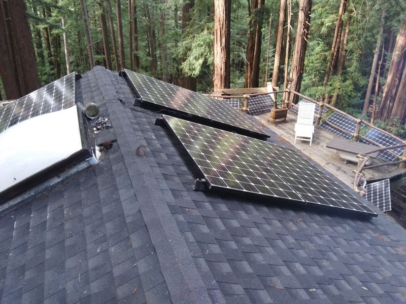

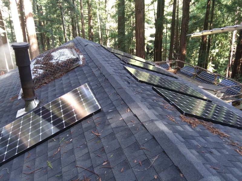

I've put some panels on my roof for testing, which gets less sun than the deck but overall probably not a big dif. Actually not bad since my ridge points almost directly north.
What are the options for attaching to asphalt shingles? I guess putting screws through into the sheathing is OK? I was thinking maybe I could make 2x4 frames, screwed to each other at the ridge but not attached to the roof, and screw the panels to them? I get almost no wind, no snow..

What is the necessity for air space under the panels? Hope it's not heat, 'cause they are sitting right on the shingles right now, hooked up, and I'm back at my city house.
Yeah I'll ground wire it when I get them mounted and situated.
# Posted: 17 Mar 2021 04:24pm
Yep, air flow for the heat, you dont want it trapped under there in the Hot Summer Sun (which, with all your shade may not be that big a deal right now).
# Posted: 17 Mar 2021 06:12pm - Edited by: ICC
Quoting: paulz What is the necessity for air space under the panels? Yep. Heat. Three problems... 1= the shingles will be baked/cooked. 2= The panels will be much hotter and hot panels have reduced power output. 3= studies show that hotter panels fail more and earlier than cooler panels
The commercially available panel standoffs for a roof mount system are often 4 inches tall with 6 inch standoffs being very available. We want air to be able to move freely to help cool the panels. Yet another reason to prefer ground mounts when space is available.

I mounted the panels on my roof onto the aluminum racks they came with. Only about 3 inches space but I have yet to feel them even warm. I have room that I could move most of the panels around my deck up on the roof but might not be a good idea, better to have them scattered for sun.
