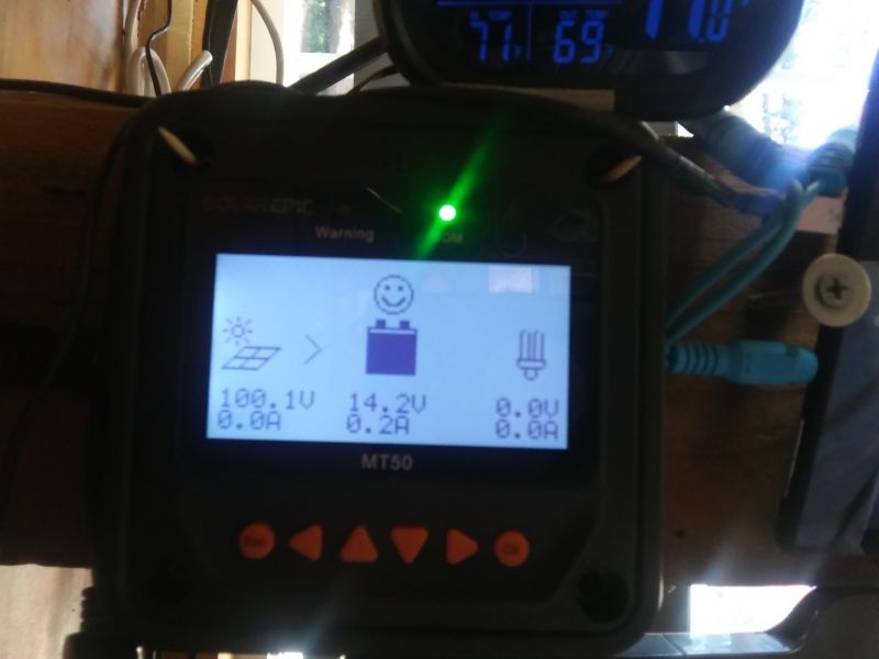

It charges that high for bulk, like after a night of draw-down from whatever you have running and no charging. Same as your car, start it up and the voltmeter goes to 14.6ish to replenish the heavy starter draw, then settles.
Once your solar switches to absorb it lowers and when into float even lower, like what you see at 13ish. Give it a heavy load/draw-down and you should see the meter peak toward or to your preset 14.6.
Is this LFP? If so, from what Im seeing Id tune that peak back to 14.4, abs to 13.2?, no equalize and no float.

Yeah I think you're probably right on kicking down the max charge. Like I said though, I have not seen it go that high recently. I think when it did was before I put those 6 more panels on the roof and the batteries were getting drained more than they do now. Even after all day cabin use now it doesn't go over about 13.6 so the 14.6 max is not coming into play from what I have seen.
I have 18 260 watt panels going now, but usually no more that a half dozen getting sun. Works great so far but if they were to magically all get sun at the same time it'd probably blow the cabin into orbit!

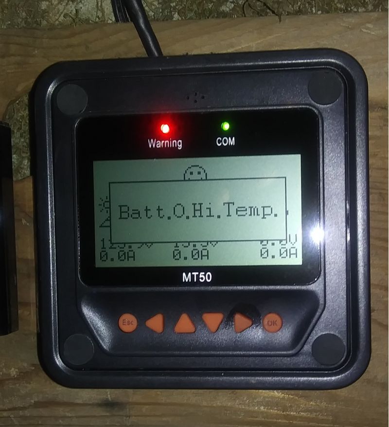

Uh oh. Went down to the shop this evening to a red flashing light on the SCC meter (MT50). It was an extremely hot day today. This system is using 4 FLA marine batteries, and I do have the temp sensor in place (obviously). I didn't use any juice in the shop all day. I left it as is, I guess the plan is to go down in the morning and hope it's back to normal, check the water and maybe get more air around the batteries. Sound good?
Just when things were running seamlessly.

Got down there this morning, red light off, 14.2 battery voltage, plenty of water in the cells. Nothing about it I could find in the manual, guess it's just a warning, probably cuts off charging. I created a little more air space around the batteries. Another scorcher today, we'll see. Funny that these batteries can sit under the hood of a vehicle with a hot engine and that's presumably OK.
# Posted: 18 Jun 2021 04:15pm
Red light back on. 90F outside, hit the batteries with the infrared temp gun, 84-86F (shaded).
Manual says this:
 Battery Overheating
The controller detect the battery temperature through the external temperature
sensor. If the battery temperature exceeds 65ºC, the controller will automatically
start the overheating protection to stop working and recover below 50 ºC.
50C is 122F. Temp sensor must be off.

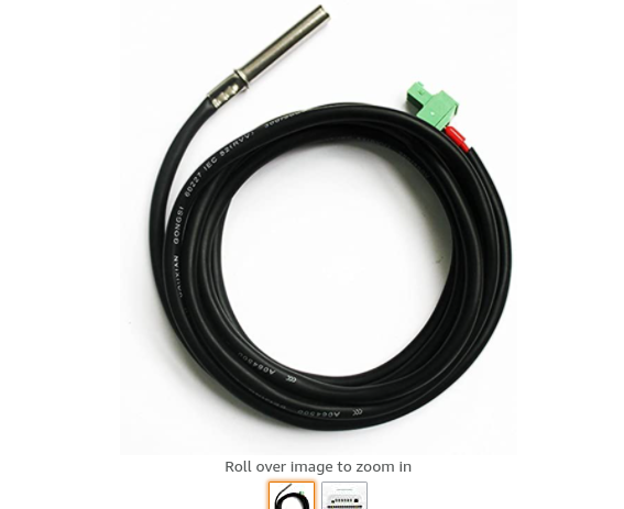

I have another temp sensor but it looks like this. The one I have on there is square and had double stick tape. Not sure how you are supposed to attach this one.

The batteries themselves can get hotter than the ambient air temperature. Heat is produced when a battery is charged. All types of batteries.
Dip in a cell. Just tape it to the side of a battery. It may not work as thermocouples are made with different characteristics.

That PROBE sensor should be attached at mid height, mid width attached to a battery with good tape on the centre inside of your bank. Do not think of sticking it inside a battery.
To clarify, if you have 4 batteries, 2x2.
[Batt-1][Batt-2]
[Batt-3][Batt-4]
You would put the sensor at the point where all 4 meet.
OR between Batts 2&4 taped to the side middle of one of the batts.
The batts get hot while charging, so use a good tape like that red sealer tape for Tyvek house wrap, it doesn't mind the heat.

LFP does not use Temp Compensation like lead.
The temp monitoring by a BMS is for operational temperature ranges. For example, no charging if cells are below freezing or if too hot, but discharge is ok to -20 celsius etc...

Anyway, swapped out the temp sensor last night, all good so far. Heat wave has subsided so won't know again until hopefully August or Sept.

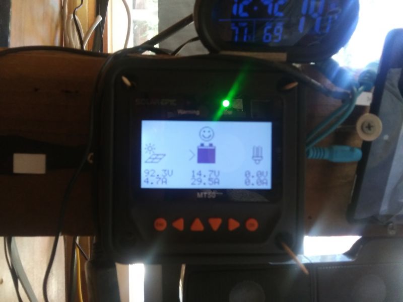

Wow, so my system voltage generally stays between 13.0 and 13.7 at the cabin with LFPs. This morning I noticed it at 12.9 briefly. I have been running the fridge colder and voltage will kick down a couple tenths when it runs. Charging amperage stays under 10.
Today, mid sunny day, I decided to charge my Li chainsaw battery, using the AC charger through the inverter. Before flicking it on I checked the meter and saw battery voltage at 14.4 iirc. No big deal, it goes that high sometimes, recovering from overnight I figured.
When I turned the inverter on and plugged in the chainsaw charger the amperage rose to almost 30! I had never really noticed a correlation between charging input and load but I guess this proves it's there, provided you have the panel input to do so. Apparently I do, and will have to be careful I don't exceed the 40a max of my SCC.
I turned the inverter off and panel went back to the usual readouts. I still find the correlation between all these amps, volts, supply and load confusing, hopefully the fuses and safeguards built into the equipment keeps me safe until I do.
# Posted: 11 Jul 2021 07:15pm
I run my system with Float on the batteries for them to balance out gently, once they are full maybe only 1 or 2 amps is going into the battery bank. The SCC may have an output of 8 amps because the inverter is supplying power to the house. If I turn on my Coffee maker which will draw 47A, and there is enough solar capacity, the SCC will deliver that without pulling anything from the batteries, as soon as the coffee maker is done, the Amps produced drops back to 8A.
If your SCC is rated for 40A that's all it will deliver, now if you put something on that demanded 50A the SCC would deliver the 40A it is capable of and the batteries would back fill the rest. Once that load is done, then the SCC will deliver what it can to recharge & top off the batteries.
