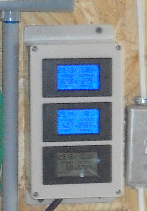

I have three of these:
https://smile.amazon.com/bayite-6-5-100V-Display-Multimeter-Voltmeter/dp/B013PKYILS/r ef=sr_1_6
I use one to track what is coming out of the charge controller into the batteries, one tracks inverter consumption, and the other tracks juice going into battery from battery charger.
I am a big fan of information overload! Sorry about grainy picture...
