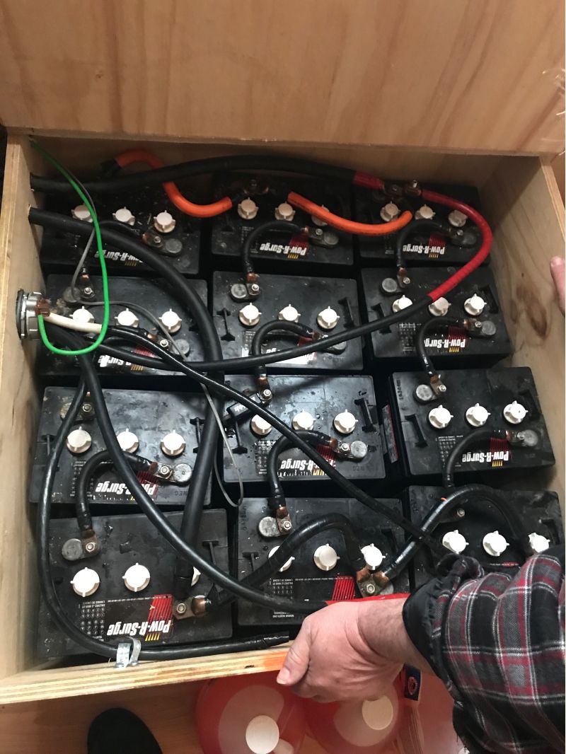

I have an opportunity to purchase a used solar system from my wife's co-worker. She is recently widowed and decided to put her cottage on the grid when it was time to replace her batteries.
I do not have any specifics of the system yet, but will be going up in a week to it.
My biggest concern is that apparently, the batteries need replacing because they have bulged. From what I remember, this is normally due to overcharging. Would this mean that the charge controller is not functioning properly?
She is not technical in the least bit, so to gain a history of what happened would not be possible.

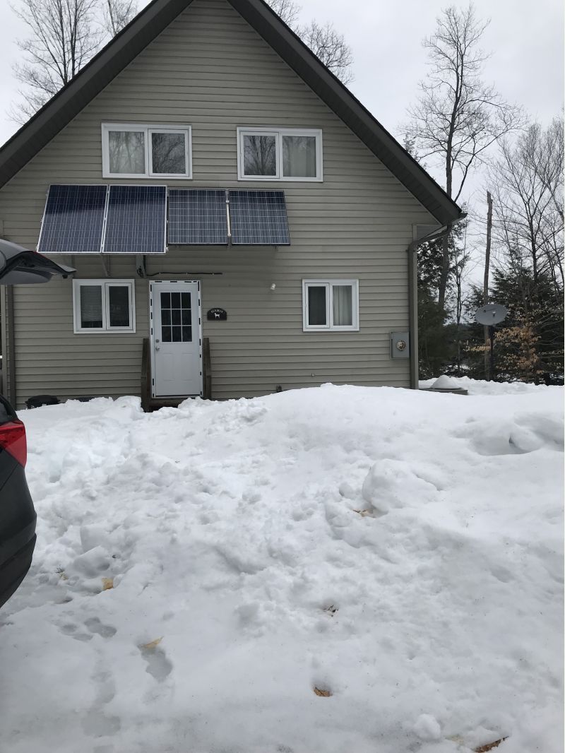

Anyways, I thought I would add a few pictures of the system. If anyone has some thoughts of the cause of bulging, as well as just some thoughts of the system as a whole, it would be appreciated! I think it's a 24v system.

Pop the white caps. Do you see clean plates or fuzzy ones?
Looks pretty clean. Time to find you some lithium. smile.

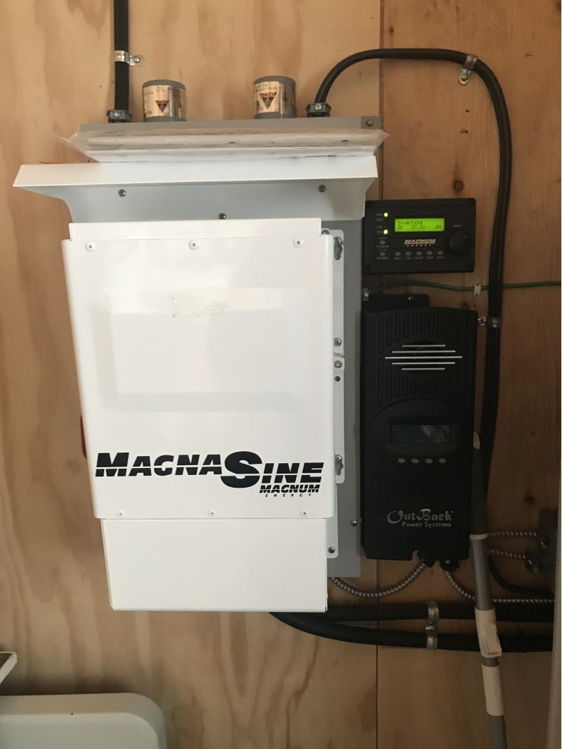

MagnaSine. What's the age? But good equipment. If with slightly higher mtbf than some. (mean time between failure).

Are the batteries still taking a charge and providing power? Where are they stored at?
A discharged flooded lead-acid battery will freeze in below freezing temps (however, fully charged they are good to something like -80f). My coworker's batteries partially froze but he thawed them out and they are functioning just fine now. I'm sure that shortened their lives but it didn't end them.

Once you get up there and get the stuff, write down / photograph Model numbers of the equipment you have, solar panels (back labels) and get the brand & Model PN of those batteries. I can find NO INFO on Power Surge Deep Cycle IF that's what they are...

Outback is First Tier product and good stuff overall.

I would not worry much about a bit of bulge in the batterys if they function correctly. But if you cant get them cheap, about 25 percent of new i woulnt bother with those batterys. They look to be just golf cart batterys. If she dosnt know the history they prob where not properly taken care of so wont be much good.

Creeky asked whether or not the plates look clean or fuzzy when you look inside. That's a good clue to the condition. You might want to set things up and try them, or just switch to lithium and avoid the potential hassles of lead-acid batteries. Those lead-acid batteries should be recycled... look up a metal recycler near you.

Power Inverter: MAGNUM 4000W 24V INVERTER/CHARGER URL and remote: URL
Charge Controller: OUTBACK 60A FM60 MPPT CHARGE CONTROLLER URL

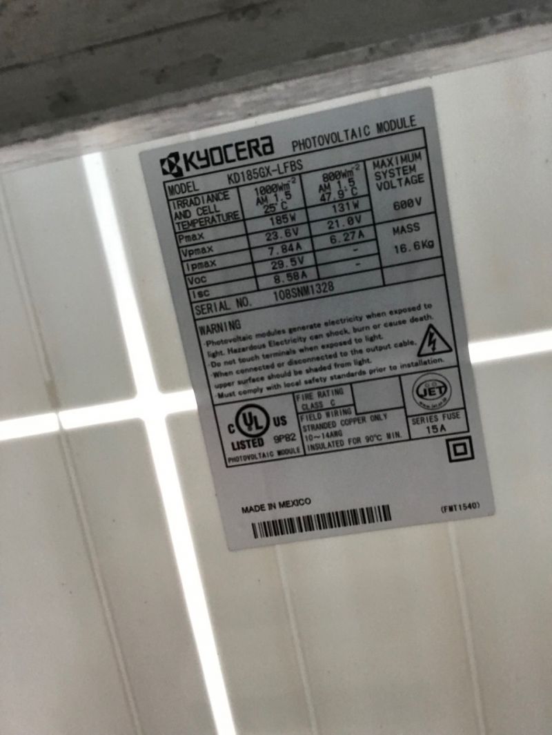

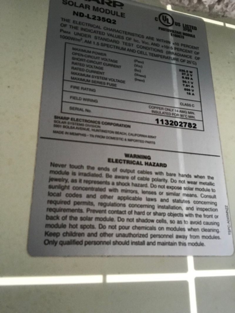

And the Solar Panels 2 of the panels are 185 watts - Kyocera and 2 of the panels are 235 watts - Sharp. I am thinking of upgrading the 185-watt panels to 275 as well - thoughts?
The batteries were left uncharged last winter and several of them have bulged. If anything, they will be good for core and then I'll upgrade.

Sounds like you scored a good deal on the equipment, sadly those FLA's are likely cooked beyond recovery... You "could" try & desulphated them for 4 hours but might not be a good plan IF they are bulged.
On the Panels, Replace the 185's ? Keep em and add 2 300+ Watt panels and your good to go.
Now comes the Battery Shopping, at this point in time LifePO4 is close to FLA pricing, recovered / upcycled Lithium from EV's = best bang for buck (for an offgridder), there is Carbon Lead too which is really good and NOT like FLA but TBH Lithium Variant is the way to go.

That is a great idea to add an additional 2 panels to the existing 4. I am pretty sure the charge controller can handle it. Does anyone know of a good source (Ontario) for batteries?
