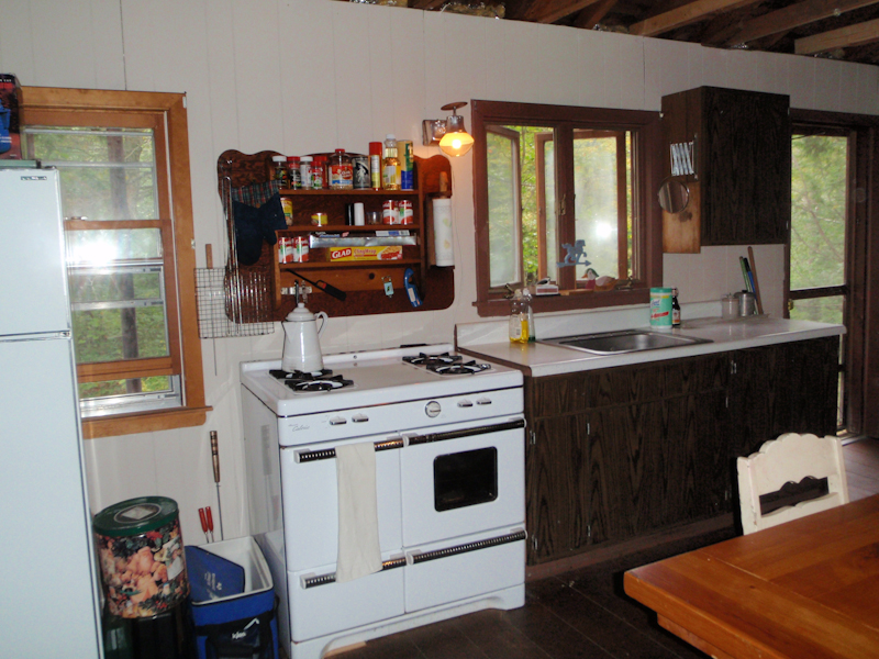

We just have a standard propane range, and use long handled "bic-type" lighters or long matches to start the range/oven. I don't think it ever had battery or electrical as an option (it's an older range). For new there are plenty of options, but you might do better finding one locally vs shipping (https://bensdiscountsupply.com/gas-ranges/off-grid-battery-ignition-gas-ranges/)
Attached is a pic of our old beast.

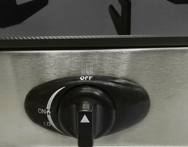

I'm seeing some cooktops that advertise 'electric piezo starting' but no mention a battery and no push button. The knob says off and on..how does that work?

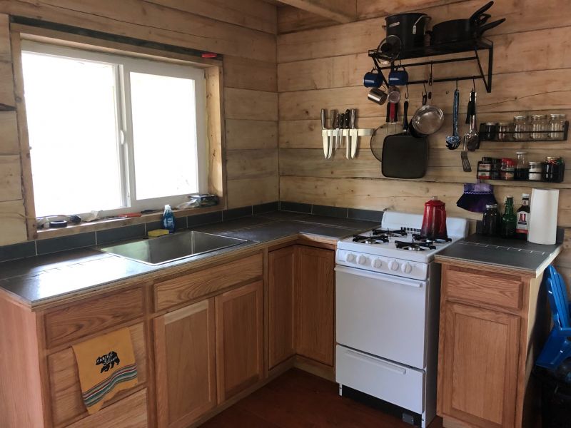

This is the Holiday freestanding gas range. Natural gas or LP. Easy to convert to LP, this one has the battery operated igniter. It take 8 AA batteries. Works great, I use the oven every trip to the cabin for cooking bacon or keeping flap jacks warm. Doesn't burn much fuel either. Expensive, yes, but worth having a stove and oven and able to cook as much food as you would at home at one time. Except don't get a large take n bake pizza, it wont fit.

If it uses a piezo ignitor there must be a push button to trip the piezo hammer someplace. I have a camp stove with a piezo. Turn gas on , press button.

After further investigation, it says you push the knob and turn. I guess the push triggers the igniter.

Some piezo ignition stoves are set up so fully rotating the knob past the "max" position triggers the piezo.
