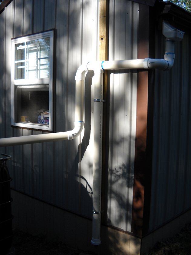

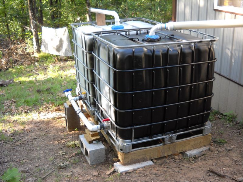

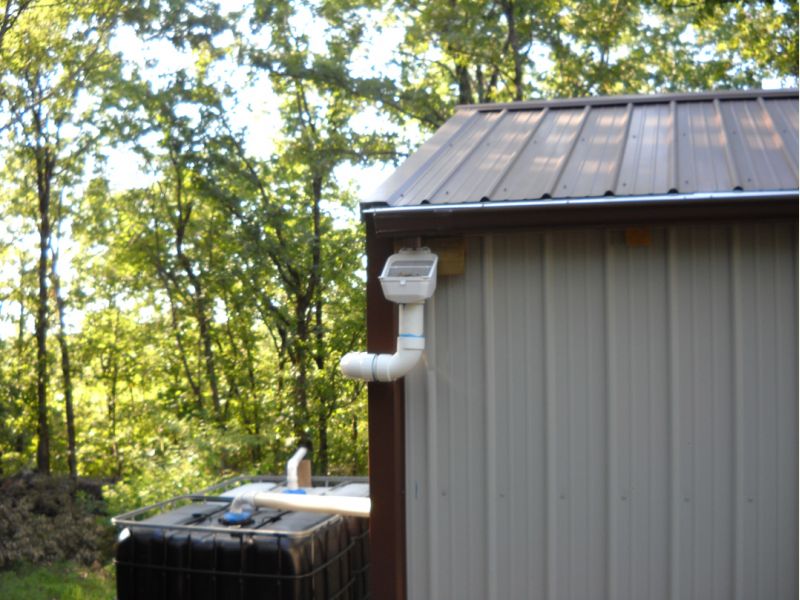

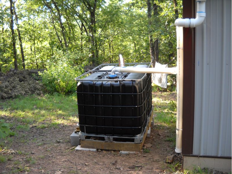

OK, been up at the cabin most of the summer and decided to take a week break to bask in the AC back at the house! We added one more tote and tied them together and now have 550 gallons of water to shower and do dishes with. This past trip I also added gutter-guards to help keep crap out of the gutters. Here are some pics.
Rain gutters with guards
Keeps most of the crap out of totes
Partially painted totes
First-flush diverter

Here is how the totes are tied together. The overflow is not finished yet since I haven't decided what to do with overflow water...

Looks great. Real simple first flush too. Cool. Makes me envious. I'm still (after 8 years) hauling water from the well. When I could have a self sustaining shower/washroom.

The first flush kit is one with the floating ball and it self-drains.

Justin, are the pipes sealed watertight where they pass through the lids. I've had a hard time figuring out how to make a tight seal through the lids on my tote. I need it watertight so that it will back up to a T fitting and overflow in a controlled manner when full.
justinbowser
# Posted: 23 Jul 2019 10:44am
The inlet into the first tank is fairly watertight and the overflow is watertight.
