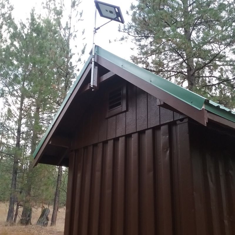

Toyota I'll check into battery tender. The batteries are cheap but i like to keep one or two extra ones charged in my shack. I have 6 feeders with solar panels that usually keep charged but once in awhile the squirrel will chew the wire from the solar panel and then the battery goes dead so I keep spares
