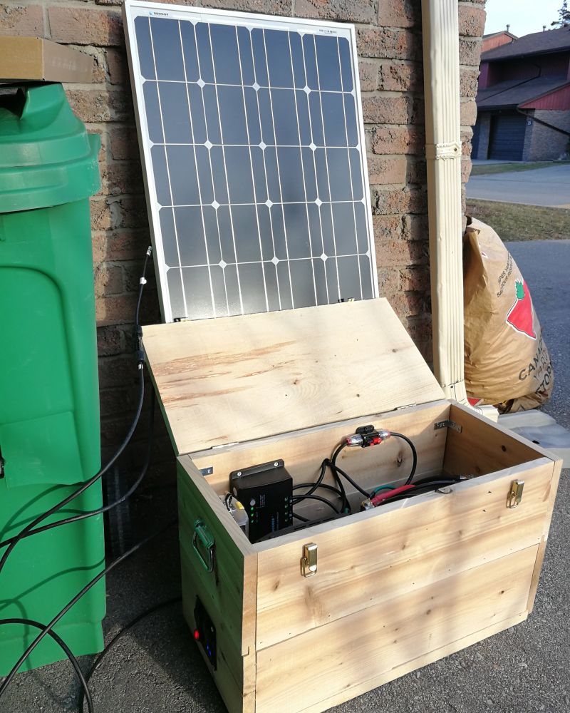

 I bought this kit but I also added fuses/breaks, 120 amp hr AGM battery, 1500W inverter (probably more like 750/750), fuse panel and some output which lives in a solar box. Its made to be portable but I will soon give it a fixed location.
 However I use mine on the weekends for very limited usage. Charging batteries for tools, phones, air pumps and camping related uses. It works great from me for this, next year I will be adding lighting in the cabin, water pump and a few other things.
 You are in a good place, but start to do some research by reading through topics on this forum, there are endless conversations on solar around here. Watch some youtube videos, there are some good guys on here that have channels. Calculate what you need as others have suggested and go much bigger than you likely thought was necessary.
 If you are going to be there full time, have a system that will allow charging through the use of a generator. Solar is awesome but its not great if you under build.
 When I build by full size cottage/cabin I will need something like a 1-2 KW system. I have a 108 sq ft bunk which we use a few days at a time, that is what a 100W system works for.

 meloj
 Very nice build. Also like the Canadian Tire Gift Bag full of leaves!
