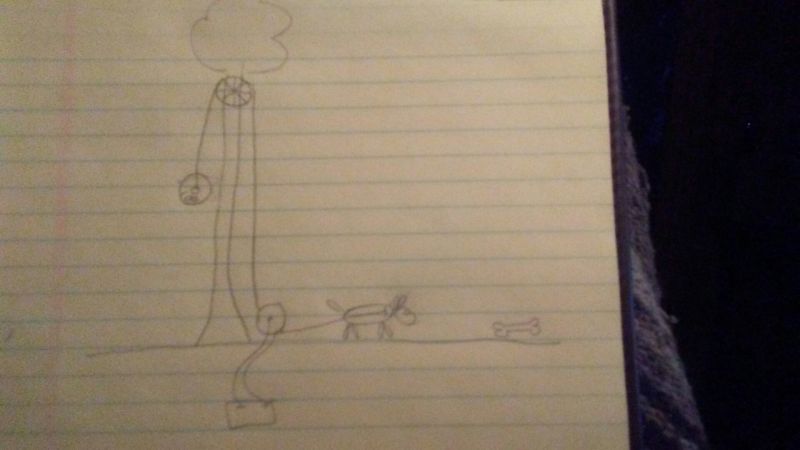

Ate too much before bed last night and got the wild idea that I could hoist a big weight up a tall tree, tie the end of the rope to an alternator pulley (or something like that) and generate power as the weight dropped.
Sure enough, you can buy a gravity lamp. I just need to ramp up the scale.

I was figuring to charge my batteries with it. I could do about 150' height. Weight would depend on what was used to raise it. My useless dog maybe.

Quoting: paulz I was figuring to charge my batteries with it.
Off-grid storage batteries? I don't think so. 15 lumens from an LED takes very little energy. The charge into a typical small scale off-gris system would be hardly noticable.
To recharge AA penlight flashlight batteries, maybe, but at what cost of materials? As wilour pointed out, this idea makes perfect sense for someone in a third world country if doing so means they don't need to burn kerosene. There are also small solar charged lights that are promoted for that purpose. Much more healthy for the people to avoid kerosene lamps.

Quoting: ICC Off-grid storage batteries? I don't think so. 15 lumens from an LED takes very little energy. The charge into a typical small scale off-gris system would be hardly noticable.
You're comparing the output of a small weight dropped a few feet to perhaps a couple hundred pounds dropped 150 feet. It may indeed be a silly idea but not as bad as you say.

Great videos. If what I could come up with proved adequate for making some usable power, and I'm not smart nor interested enough at this point to calculate if it would, I wouldn't mind if it took running a gas engine for a few minutes to winch the weight up if it would then provide some hours of quiet, trouble free power generation. Right now my only source of battery charging at the cabin is running generators as I have no sun for solar. I use deep cycle batteries in my truck and charge them back at home or when I drive.
# Posted: 7 Jan 2019 09:34am
The problem is there is no free energy. You will get losses using your generator to hoist the weight. It would be more energy efficient to use that generator time to directly charge your batteries.

I use my generator frequently, daily, to run power tools, my only source of AC. Only recently did I realize I should have a battery charger connected to it at these times since it has plenty of capacity and I generally leave it running for periods between running the saws etc.. It could also power an electric motor to hoist the weight using this otherwise wasted energy.
But that's really a side issue. What I like about the gravity idea is it could 'run' at night, while I'm not there, or when I just plain don't feel like listening to the generator. If that means wasting a bit of energy so be it.
Again this was just a wild idea. No idea how much power it could actually produce, or for how long, or what it would take to hoist the weight. But it is an interesting thought and I appreciate the comments.

A one pound weight dropping at 1 ft/min would produce 0.023 watts, scale it from there. Conversely, to produce one watt you'd need 43 lbs dropping 1 ft/min, or 1 lb dropping 43 ft/min.
# Posted: 7 Jan 2019 01:17pm
Well that doesn't sound too beneficial. Thanks!
