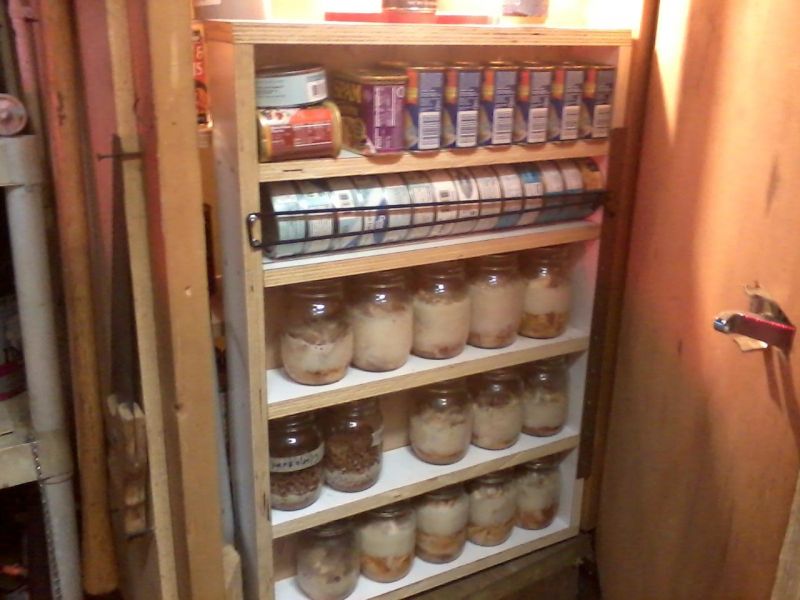

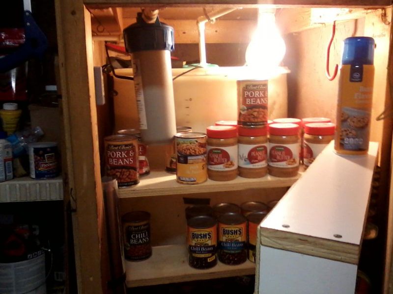

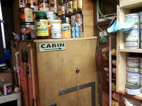

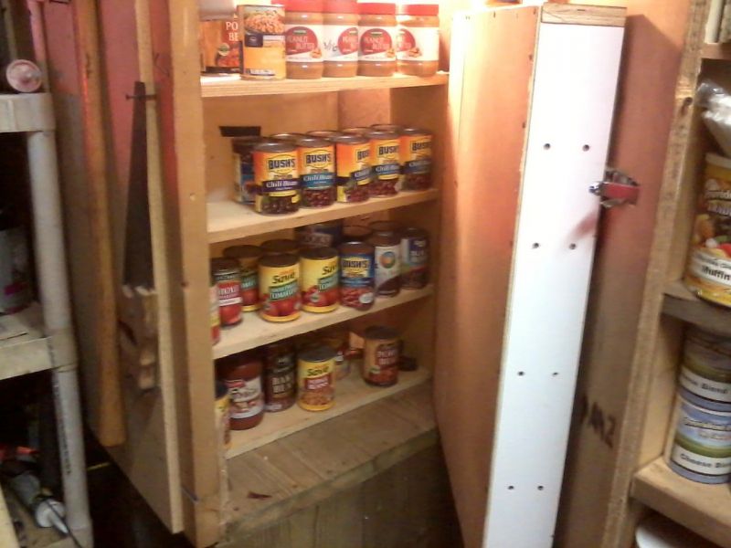

If your solar set up can keep a light bulb lit 24/7 when your gone. This might be an option. I have a store room. I built a "water closet". It has a 55 gallon fresh water tank inside. It has a single light bulb in it that I turn on when temps drop around freezing. That keeps the water tank from freezing. I also incorporated swing out shelves for canned goods.
Water closet
Water closet
Open closet/first swing out shelf
Second shelf in closet
Tank and filter in back of closet

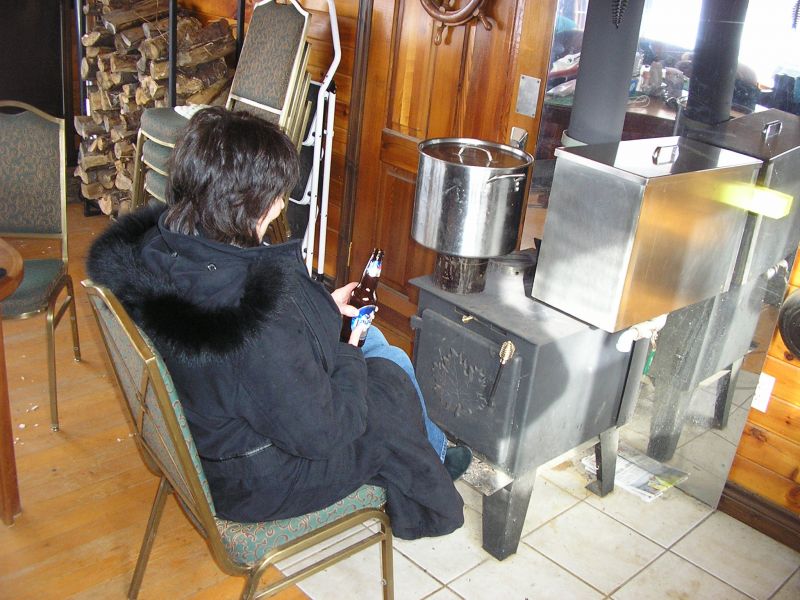

i'm in Nova Scotia, so I would think a similar winter. I gave up trying to keep water from freezing. In stead, i just melt snow or ice and pump it up to my inside water tank. The wood stove has a nice stainless steel tank to fill with ice and snow. The water barell inside gets warm from the wood stove. When leaving I just drain everything down.
