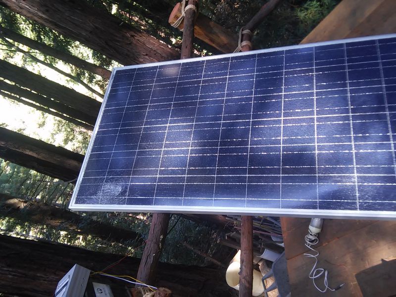

A friend gave me this panel yesterday. Must have had a branch hit it but it still works fine. Can I just put clear silicone or tape on it, no potential danger?

Even blocking a single cell will seriously hamper the output of a solar panel.

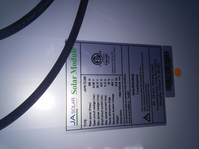

Maybe creeky can look at the specs in your second picture and tell you more about the charge controller and what batteries to use. And also about possible repair options.
The panel was free. But figure out how much it will cost to get it hooked up and putting out electricity for you.

The is a reasonable chance that only the tempered glass overlay sheet is cracked and the cell itself is okay. The potential for water getting in there and causing grief is the big worry. See if you can find a supplier of transparent laminating film. Orafol makes several of these films. Sometimes a sign shop will sell you a piece off a roll. Some of the varieties are used to make those graphics that get applied to car and truck bodies, others are used to laminate a printed sign and make it more weather resistant. There are also varieties that are sold as a stone guard material to be used on the front of a trailer. They can be clear to let color show through; some are colored, you don't want them.
You wrap the entire panel front with it and turn the edges under to the backside. Seal and shrink it to fit with a heat gun. We used some that had a claimed life of 8+ years. That was two years ago and the film still looks clear and has stayed attached.
You say the works but how was that arrived at? Bothan amp and a voltage check against specs? Volts only means little but is easy to do. Just does not mean much without knowing if it can also produce the rated amps.
In bright sun the panel volts output should be in the neighborhood of the Voc rating, 44.5 volts. If you have a multimeter with the ability to measure at least 10 amps you can check the short circuit amps. That panel in bright sun should give you about 8.5 amps, the Isc value on the label.
Then if you have no other solar equipment you will need batteries and a charge controller to use the panel.
Keep in mind that if you want to add more panels to be used with this one best results are to use the same panel brand and model. At the very least the amps (Imp) output and the volts (Vmp) output of other panels should be within 10% of the ratings for this panel.

11am and sunny. 43 volts but only 2.5 amps. I have the cheesey red. HF ammeter in series.

I have no idea what to do with that panel. I have only seen shattered face sheets on a solar panel once.
But if you could get it water proof it would be neat to put it on a potting shed with a tiny 10a solar controller a couple of lithium tool batteries and a tiny invertrr. Lights, charge your power tools etc.
I'VE been kicking the idea of a solar powered garden shed for awhile. You could put the thing anywhere. Pump water. Light up a yard.
Free panel is sure a good start.

Hey Paul. If you get it figured out if the panel is working and worth saving. Maybe you could see if a windshield repair shop could repair/reseal it just like a cracked windshield. Just a thought.

Sorry for the late reply. Had a chance to test the panel again in full sunlight with a couple of meters. Still only 2.5 amps shorted, also hooked up a 12.2 car battery and amps went to 1.75.
Sadly, I am afraid that panel is about useless.
