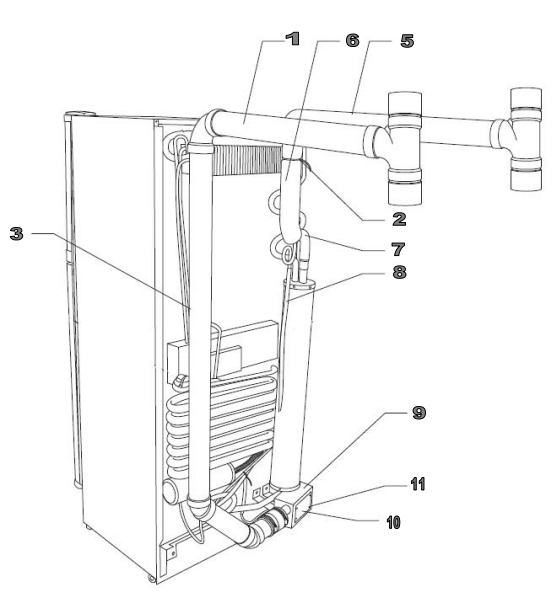

It is CO, not CO2, you need to worry about. The fridges have CO alarms, not CO2 alarms. Too much CO2 in the air we breath is not good for us either but CO is the product of poor combustion and the red blood cells in our body prefer CO to O2 (oxygen). CO can kill you quickly.
Copied and pasted from the Unique websight--- "*In Canada according to the 2010 Canada B149 Installation Code, if a propane fridge is being used in a dwelling it shall be of the direct vent type. The direct vent propane fridge must be located/ installed on an outside wall (max. 18â€/46cm distance from outside wall). In all other applications in Canada, you can legally use propane fridges with either a CO alarming device with safety shut-off or direct vent system, based on your requirements. Please use a licensed gas fitter to install. *"
CO detectors have a limited life. My stand alone CO detectors cease functioning after 5 years and need replacing. I have heard, BUT HAVE NOT CONFIRMED, that the same thing happens with the detectors in Unique refrigerators. Worse, I heard, BUT DID NOT CONFIRM, that a new compatible CO detector/alarm costs a couple hundred dollars and that the fridge won't work without an operating detector. Check that out before buying. Like I said, it may not be true, might be an internet tale. Sorry if that info is not correct. I can not find any info on the Unique website, but I now recall reading that someplace. Have no idea where.
Here's a drawing that shows the venting system Unique uses
