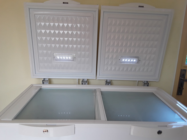

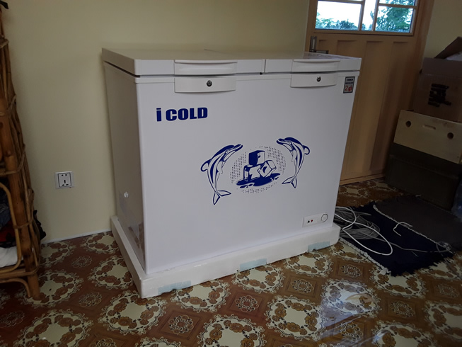

It just so happens that I also own a Samsung Inverter Refrigerator, two actually. I also own a horizontal refrigerator / freezer (like a chest type deep freezer, except half being a refrigerator.) The horizontal model runs a "typical" old style compressor.
My Honda EU20i can power BOTH inverter refrigerators, fans, my network and two desktops, as well as various lights and fans around the home. During power cuts, I run that little compressor on "Eco-Mode".
Of course, I am not running air-cons, electric kettles, water heaters, ovens, toasters, etc. I am only running typical lower wattage appliances that I really need to have running, during power cuts.
mattd, that little generator NEVER comes off idle.
Now, if I were to plug ONLY the horizontal refrigerator / freezer into it, the generator would bog down as soon as the compressor powered on. So much so, that we would unplug it during power cuts. I certainly do not wish to damage my generator - definitely not in this country. In fact, we ended up deciding to empty that refrigerator / freezer completely, and unplug it. (I kinda regret buying it, honestly. I should consider selling it, in fact. I just don't need such a power hog.)
Anyway, that is my experience with traditional / old style compressors, versus new inverter compressor technology. I never want to go back. In fact, the next appliance I will be buying, is going to be an inverter air-con.
