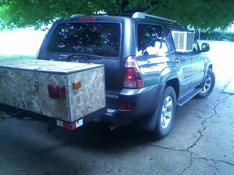

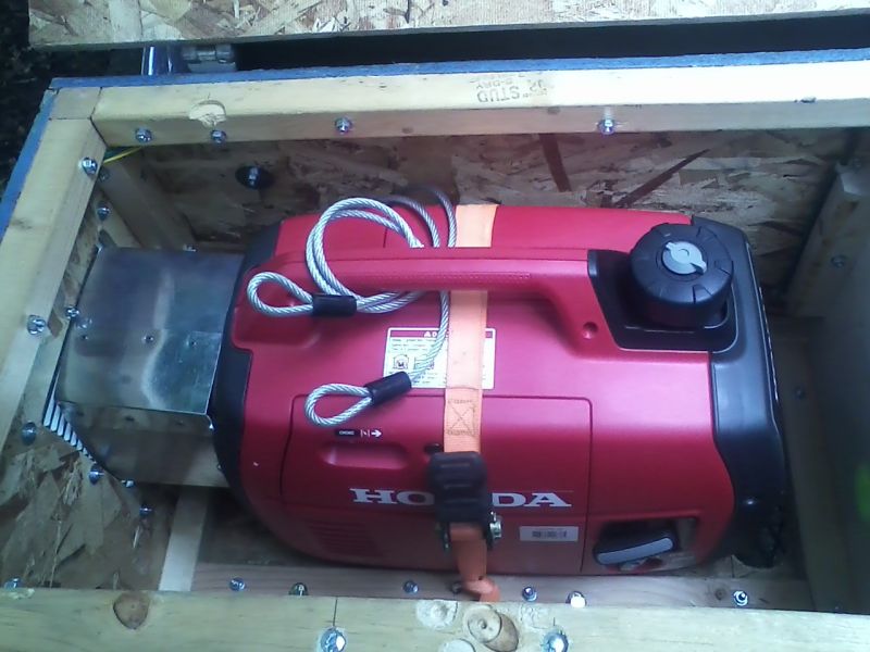

I ended up with one of the eu2200i gens this summer. I needed something to run a small window AC unti in my 4runner for travel with the dog when stopping or if I broke down. It wouldnt quite run the small 5000 btu AC unit on eco mode, but with the addition of a hard start capacitor plugged into it ($12 locally) it runs fine on eco mode so the fuel lasts much longer and it isnt as loud. It rides in a cargo box on a hitch mounted carrier, the AC unit in the side window of the 4runner. Makes summer travel with the dog less stressful for everyone. Ive just been using ethanol free gas. Its pricey, but I dont need much. Supposedly easier on the carb to store longer without problems.
Can take the dog when running around town when its hot out, leave her in the truck with the AC set on 66 and shes cool as can be when i come back out. Have run it up to 3 hours at a time testing and its been fine.
The RV and boat forums had this stuff figured out. I just looked for the exact model capacitor and called around and found one. The link above shows the correct one. Supco SPP6. It plugs onto the capacitor in the AC piggybacked on the existing one. I zip tied it to the side of the AC case. Cargo box and AC
|  Gen in box
