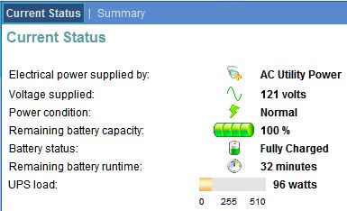

EXAMPLE: I have an LG 47" LED TV (used as computer screen) a Satellite Modem (25w) and my HP EliteDesk i7 Computer and with all cores running on PC I'm using 91 Watts.... See pic below from the UPS it's attached to.

Power used for TV, Puter, Sat Modem
