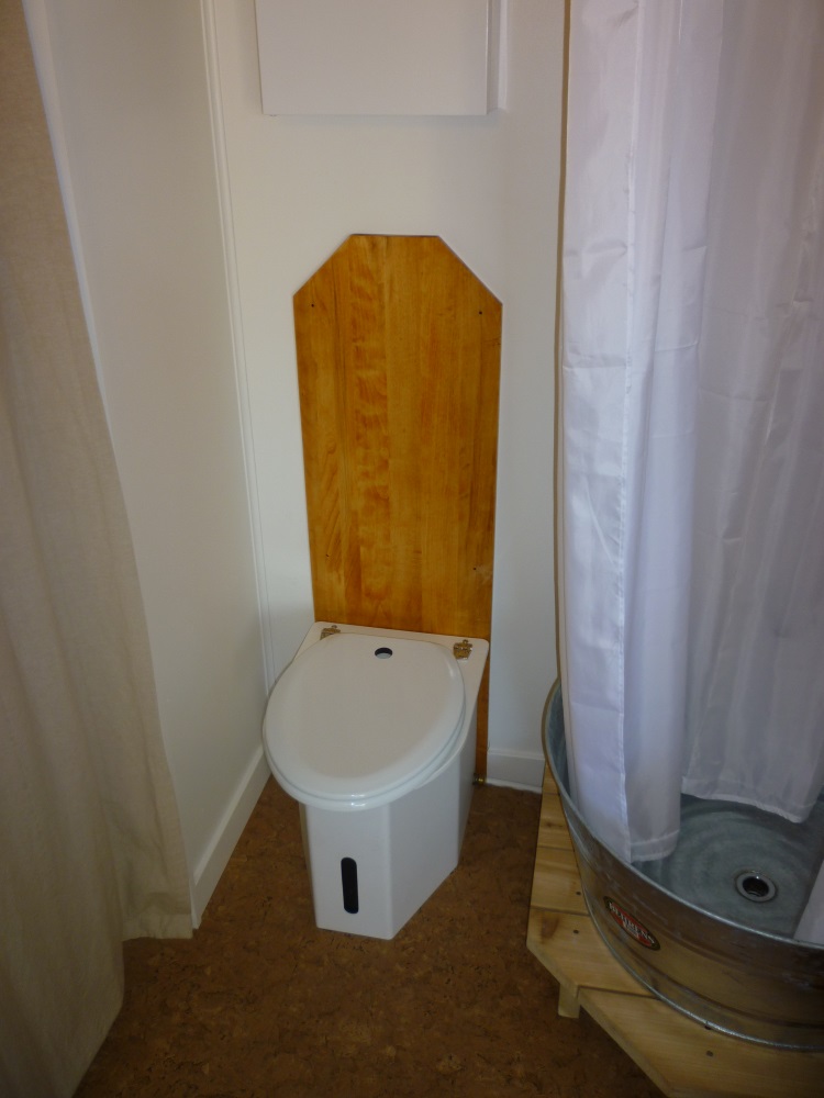

I also have the C-Head BoonJon toilet and have been VERY pleased with it so far. When I was researching indoor "composting" toilets, the C-Head was the perfect toilet for me - except for the gallon jug urine collection system. I contacted Sandy at C-Head and told him I would love to have a version with a direct line to my drywell, and would be the first to buy it and test it out. I ended up getting the first EUD model he made.
I love that it's a urine diverting unit that doesn't mix urine with solid waste. I also like that it looks and feels more like a regular toilet than most everything else on the market. I've also made extra solid waste receptacles out of inexpensive 5 gallon buckets, and treat it more like their new churnless models. I consider it a best buy among composting toilets.
