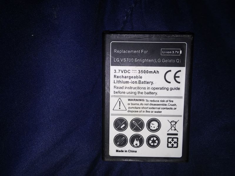

I have a leftover extra large phone battery I want to use in place of the two AAA batteries that power a small speaker. I tested it, works fine. Can I recharge this battery using a regular USB 5v charger, like you would if it was in a phone? It has 4 terminals, the outer two are + and -. Or do phones have circuitry that limits the charging?

Temperature sensing. If you have a high quality multimeter measure the resistance between the two "extra" terminals; not the + and -. The resistance will change as the battery warms or cools. There is a thermistor wrapped in the battery pack. The resistance change in turn will tell the charger to decrease charge current if the cell or battery gets too warm.
3.7 volts is the nominal voltage of the battery. At full charge it will read about 4.2 volts. Going higher than that damages the cell internally. Going below 2.5 or so also damages the internal structure. Never discharge Lion below 2.5 or 2.6. I try to go no lower than 2.9 to 3.0 volts with my lion equipment. Charging after too low a discharge is one cause of those lithium cell fires the news features every so often. Discharged to 3.0 is more or less discharged, IMO.
Phones have a charge circuit built into them. They use the 5 volts from the USB port and step down. You need a charger circuit to be able to charge it. If you are handy something like this could be used. I've used a number of these cheap boards. They do NOT have reverse polarity protection and blow the chip instantly! Be careful.

Thanks! So with these I don't worry about the two middle battery terminals for the thermistor?
If you don't pack the cell inside a tight enclosure that can not dissipate the heat, no need to worry about the thermistor. The cell states it's 3500 mAh. That can be charged at 1 amp with complete safety. I charge 3000 + mAh cells at 1 amp all the time. The cells are open to the air. They barely get warm.

Well I'm go to go. Robbed a charging board out of something else, hooked it to my battery, got it up over 4v, played my speaker for a couple hours and it was still over 4v.
Thanks ICC! Carry on.
