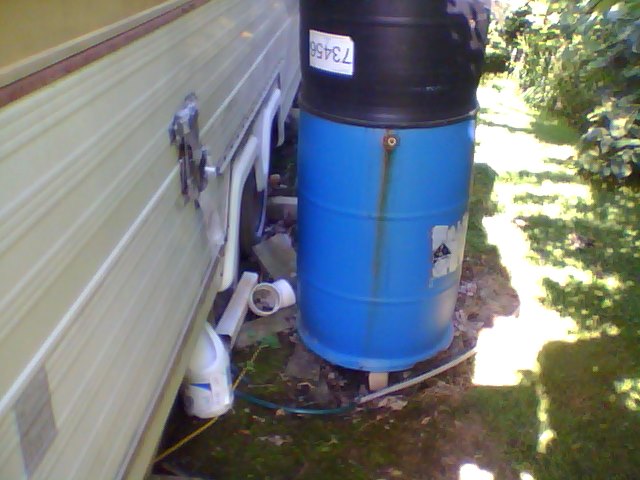

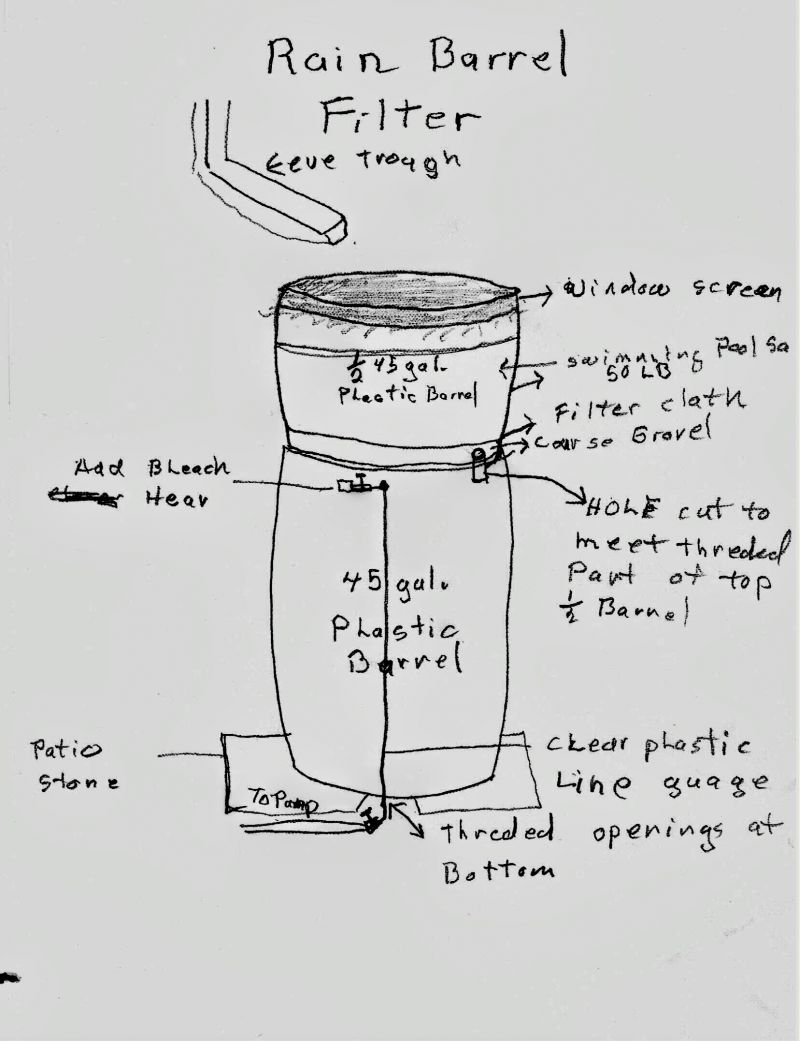

IT is very important to filter your rain water before is enters your storage tank .this is the system I use , if you get organic material in the tank it will grow. the missing word is pool sand CCE02142011_00000_2.jpg

Best to filter the water before it leaves the roof, with high quality gutter filters such as Gutter Glove. Also it's very important to devise a first flush mechanism which diverts the first flush of water off the roof when it first rains. Gets rid of dust and bird poop. If you use an on demand water heater inside, it should be vented to the outside, so yes, you should get a heater with a vent. There are some that don't require electricity. Good luck
