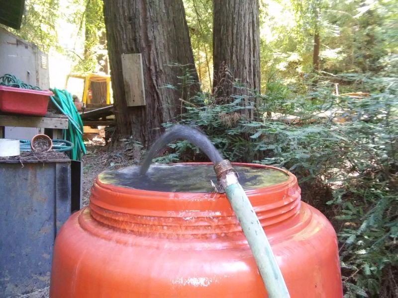

Thanks guys. So the plot now thickens.. On another well thread I had some time ago I was dealing with silty black water in this well. Suspecting I might have a leak in the casing, I put 6" solid corrugated plastic pipe all the way to the bottom, shoved it in as far as I could and cut it off with 2 feet sticking out. Then put the pump in a couple feet from the bottom. Now I've pumped out 200 gallons and the water is still silty black. Disheartened, gave the plastic pipe a shove and it went down a couple feet, to just below the top of the casing! I'm guessing, after sitting for 50 years, the bottom of the well is filled with silt. Going to try pumping more water now.
# Posted: 7 Jul 2017 05:51pm

My suggestion to you is get the corrugated pipe out of the well while you can still get hold of it. It is doing just what you want right now, helping pull the silt out of the well. You stated that the pipe has lowered to the top of the casing and as you pump it more silt will come out and the pipe will go down more. The only way water can get to the pump is up the bottom of the pipe. You really dont know for sure how deep your well is, as you pump the silt out the pipe will keep going down. when the pipe stops moving you might think you have succeeded,but when you come back in 6 months and turn pump back on you may not have any water, because the silt has set up around the bottom of the pipe and might not allow water to come in. Then the pipe is 20 ft in the well and you may not be able to retrieve it. Just something to think about. It would of been better if you had not cut it off you would of had something to pull it with.
# Posted: 7 Jul 2017 08:36pm

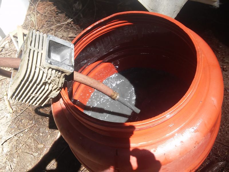

Thanks guys. I'm done for the day. Pumped another couple hundred gallons, still dark, see photo. The corrugated pipe is now 2 feet below instead of 2 feet above, so yes I'd better pull it out now, that's not helping. Other than that I guess just keep pumping and see if the bottom keeps dropping.

Ugh, what a pic that is, good use for that old head though. Good idea using the barrel to figure your volumes too... Good Luck and hopefully it won't take much to clear.

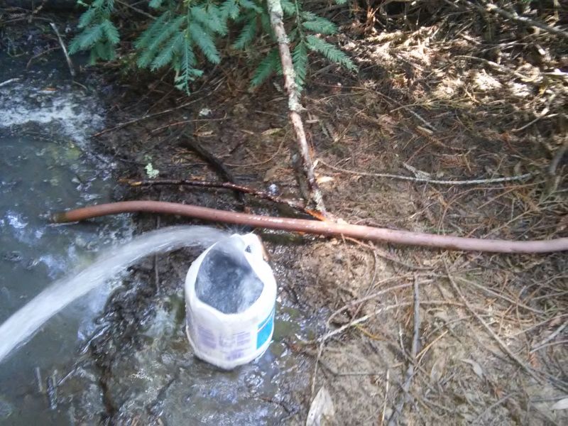

This morning I pulled the pump and plastic pipe out of the well. Then dropped in a 110v submersible sump pump all the way to rock, er silt, bottom. Pumped for about 2 hours and the water began clearing. Lifted and reset on bottom, water black again as in photo. Lifted pump 3 feet, water clears up noticably but still merky in test container. Guess I'll just keep gping.

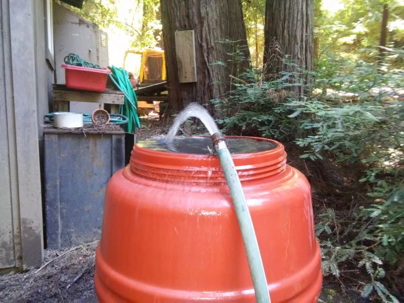

I'm getting pretty clear water, still pumping from the very bottom with a sump pump. The sediment in this container shows up just a few seconds after filling. With the submersible well pump 5-10 feet off the bottom and sand filter I should be good. Been waiting 5 years to take a hot shower out here.
