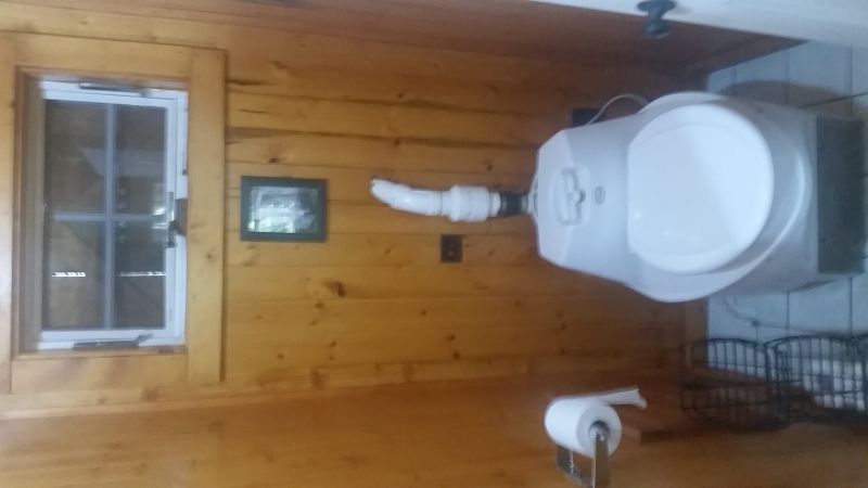

Thanks for the reply! I definitely have a commercial made compost toilet. The nametag says "Humus " It is just like you say as far as setup - trays on the bottom and a drain line underneath the trays. The previous owner was pretty clueless as to how it worked- he said he had no paperwork but I did find the original paperwork in kitchen drawer. There is a humidity dial? which I adjusted in the back of toilet. When I use it (#2 only) I add some dry peat moss and turn the handle a few times per instructions. I usually throw my coffee grinds in there as well. There are 2 fans with the toilet. 1 is a regular 110 plug which only runs a short time (under 2 min) before the inverter shuts down- I usually run gen and run fan for awhile. Second fan is a mystery - it appears as though there's a smaller fan installed in the vent pipe which uses the same connection as speakers, you push button down, insert wire and release button. When I bought cabin just around a year ago the seller had his electrician come over and he said that the small fan might be too muvh of a draw and to leave it unplugged. Should there be a fan running all of the time? I did thoroughly clean out the toilet - the ammonia smell was absolutely overpowering - with the big fan running you could smell the ammonia outside. I did notice a small drain line- I did not check to see if it was plugged- there was alot of fluid in the bottom trays- all of the material was completely saturated - it was not a fun experience as you can imagine I'm going up Monday to open the cabin up for the year - plan on a complete cleaning again - will have to check that drain line Lastly, is there a startup or do I just use it and add dry peat moss? Or do I moisten it? With water, not #1
Bigred292
# Posted: 6 May 2017 10:14pm
Here's a pic
# Posted: 7 May 2017 09:22am
a lot of composting toilets have a 12v inline fan in the vent pipe to help with ventilation. That might be what you have. That being said, your vent pipe looks awfully small. Since they all work by the same manner, you might learn by reading the instructions on Sunmar's and other websites.
If yours is that wet, its not working properly! Find the cause and fix that would be your simplest route.
moneypitfeeder
# Posted: 7 May 2017 10:24am - Edited by: moneypitfeeder
The pic looks very similar to a biolet 10 or 15, but I'm not certain. If so, then they have a float switch that senses extra fluid and kicks up a heater & a fan to evaporate it away. If it is a biolet, then I'd make sure everything is wired and running correctly, they are fairly technical, and if 1 piece of the puzzle isn't quite right... https://www.biolet.com/pages/learn-moreURL https://www.biolet.com/products/biolet-composting-toiletURL
Bigred292
# Posted: 7 May 2017 12:03pm
That does look a lot like mine but there are some differences. I have the thermostat in back, when you sit it does open doors but the arms that mix are different Maybe the 110 plug I mentioned earlier is a blower mounted below? I'm going by what the previous owner told me The paperwork I have does list an address in Sweden- I'm at work now but will check on it when I get home Perhaps mine is an early model?

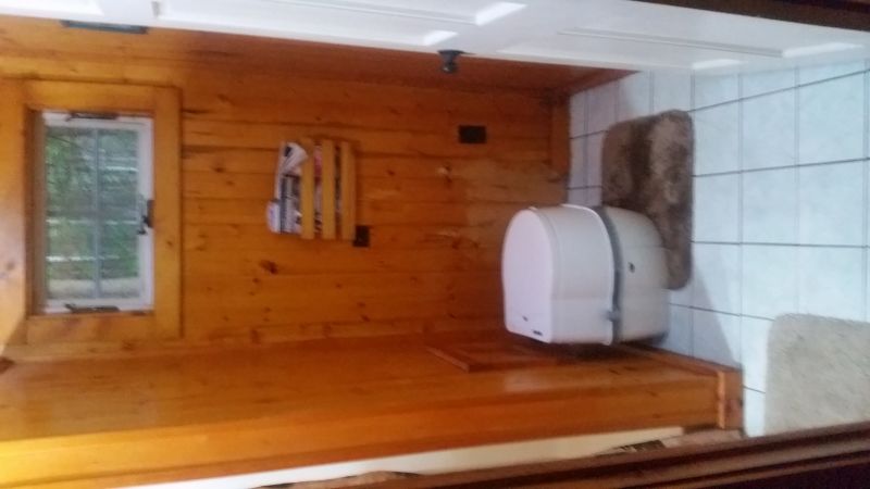

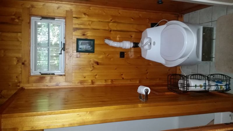

Just wanted to give an update on my situation - I actually found a Thetford curve on CL about an hour away from me. They were asking $60, still in box. Told the guy it really wasn't worth the time to make a 2 1/2 trip but thanks anyway. 3 weeks later he offered to deliver it to me for $40! Went up to the cabin last week - removed composting toolet and got the Thetford up and running. I used it for 2 days, so far so good. Sold the composting one for $250 while I was up there too It definitely gives me more room too. Only thing I wasn't sure on was how often to empty it? Every visit? Going back up within 2 weeks so I decided not to empty it until then. Time will tell I guess. Any curve owners tell me what they do? My local Walmart had Campa chem boxes on sale for $1 each so I bought 12 boxes- should last awhile
Bigred292
# Posted: 20 Sep 2017 02:22pm
