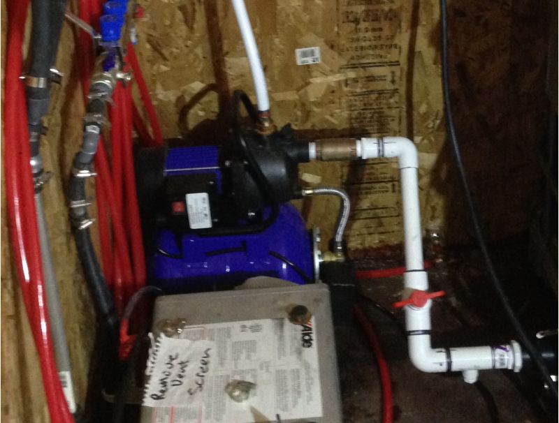

Just; the issue I have while showering as follows. When I start the water flowing the pump is off and at max pressure and flow. As the shower goes on the pressure and flow drop until the pump kicks back on. 30 seconds or so later the pump shuts off again as it hits the high cutoff setting on the pump switch. This cycle of on/off continues. Because I am using a demand water heater, as the flow rate through the heater decreases the temp of the water out of the heater increases and vice versa. In this case we go from lukewarm to scalding hot and back again. I am unclear how a bigger pump would solve this. I was thinking either a bigger pressure tank so the pump won't cycle during a shower although the flow would still change to some degree. The other alternative would be a regulator at the heater inlet or going to a smaller pump that would not cycle at all. Thoughts? sorry if I hijacked the thread.
# Posted: 21 Mar 2017 03:58pm - Edited by: Just
Sorry Al I was refering to Rickkrus's problem I see buy your pic you have a much bigger pump . not sure what kind of pressure tank you have but you may need to add some air to your tank or adjust your pressure switch so it kicks on at a little higher pressure.The adjusting screws are inside the power box on the pump There are 2 screws follow the instructions inside the cover.You will want to raise the cut in pressure and leave the cutout the same ..It should cut in about 35 lb and turn off at 40lb that will solve your hot cold problem.
Rickkrus sure flow pumps have factory set pressure switches not adjustable to my knowledge.
