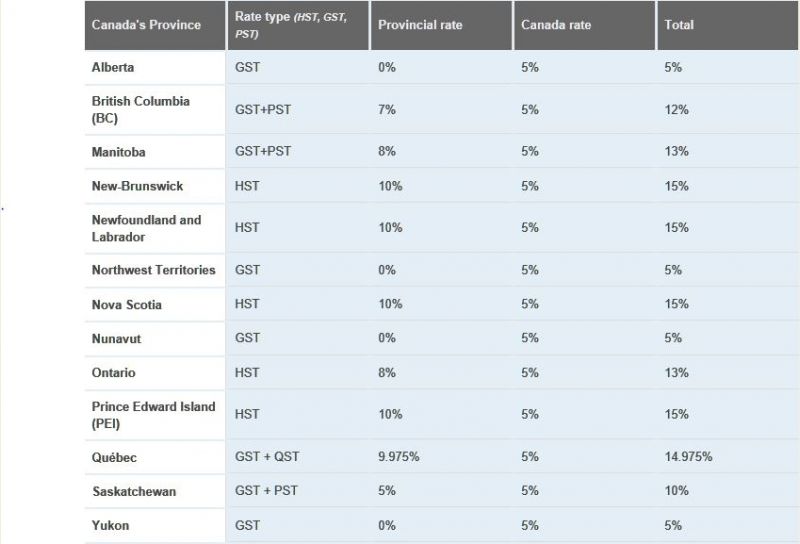

In Canada the taxes are slightly different depending on Province / Territory. Some do PST+GST others use HST only.
PST = Provincial Tax,
GST = Goods & Services Tax (federal),
HST = Harmonized Sales Tax (gst+pst) Tax Rates vary on the PST part... See attached Table (2017 rates)
cdn-sales-tax-rates
cdn-sales-tax-rates

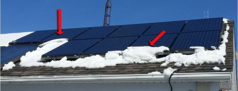

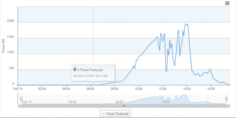

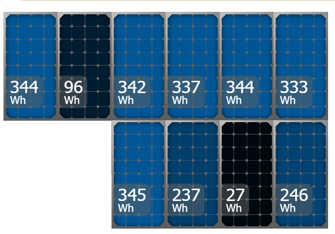

If you're having trouble deciding between string and micro inverters.
Here is my gfs production the other day. Pic one shows the snow. Pic 2 shows the effect on panel output. Amazing how little shade it takes to pull the output down. Dramatic really.
Also. Pic 3. Today the panels were clear but we had cloud moving through. So 7 kw of daily production from 2.5kw of panels. Look at the power output bounce with the cloud. Yesterday was clear. 10 kw made.
