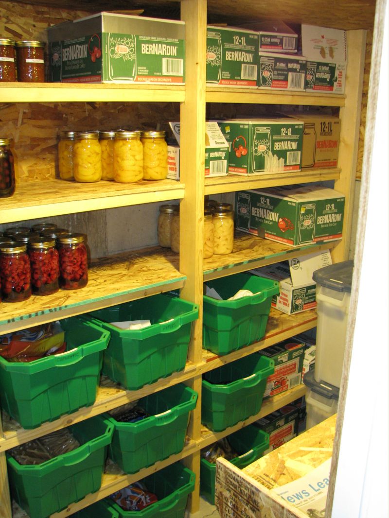

# Posted: 11 Feb 2011 10:52pm
We don't have a root cellar but do have a cold cellar under our house. It stays nice and cold but nothing freezes.
Our only problem was dampness which we solved by using something called Moisture Magnet. It doesn't use electricty and you just dump out the tray of water as it fills up. When the chemical runs out, you replace it.
Mice can also be a problem so make sure you have a baited trap in the room at all times (and don't forget to check it daily *S*).
All of your food should be in mouse proof containers if possible. We keep dog food, flour and sugar in big sealed plastic tubs. Obviously that won't work for potatoes or apples or such that need to breathe. We find open plastic tubs work great for those, but you have to check your open food regularly and remove anything that begins to rot before it ruins the rest of the food.
