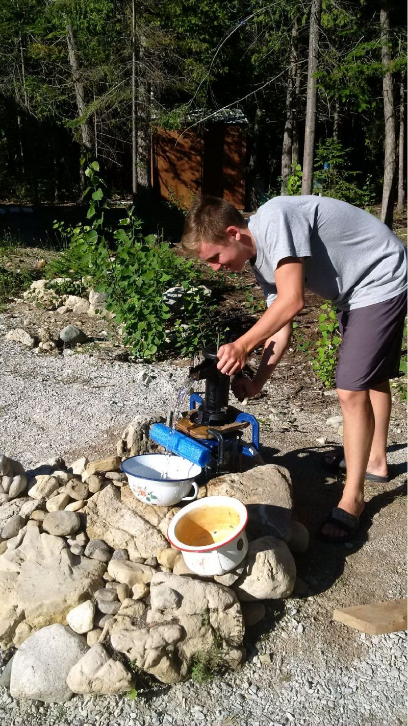

Hi Julie, We have a drilled well with a hand pump attached to the top of the pipe with a few clamps. Hand pump cost me 60 bucks and it is attached to the plastic pipe that goes down the well (drilled at 120ft, but water is prop 20 - 30 ft down). Have a valve at the end of the pipe to keep the prime...works great for us. my son pumping it after we replaced the leather gasket

bushbunkie That's awesome! How does it do in the winter/colder temps? Gosh, that water looks so clean and pure!

Hi Julie, Thanks...We're just seasonal cabin dwellers at this point, don't use it in the winter...yes the water is awesome. For something long term, you'll definitely need a pump system in place.

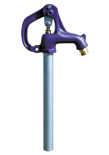

You could also use one of these if your ableURL
Julie2Oregon
# Posted: 6 Sep 2016 08:20pm
PatrickH Whoa, that's really cool! Thanks for linking! I missed it on their site!
