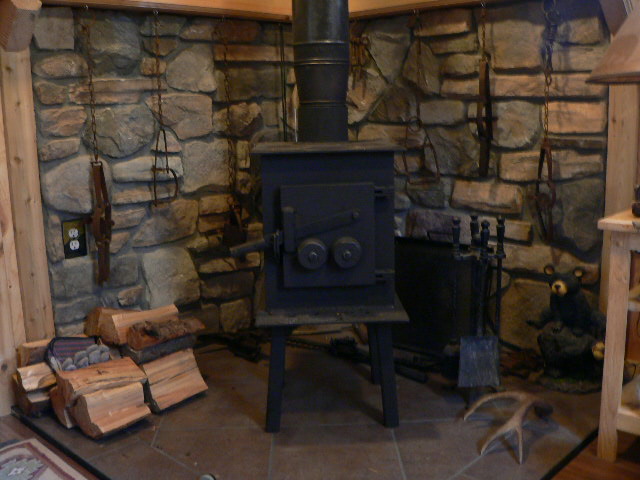

I just couldnt find one the size I wanted and in 1/4" plate steel. I was limited and didnt want to be crowded. Didnt want cast iron, especially cheap leaking ones. Either too big or too small, or too deep on the proper trash burner style. So I ended up just making my own woodstove.
Its EPA certified too. I certify that "Extra Paint Added" to keep it nice and black.

# Posted: 28 May 2016 09:56am - Edited by: toyota_mdt_tech
Travis, cast iron stoves can and do crack (mine was, didnt see it till I removed it) too, they are multiple parts (my old cast one had 6 panels plus the 2 outlet options, ie top or back, loads of seams) and each part has a seam and can and will leak air. I had a Fjord trash burner style, couldn't shut it down well enough, run me out. The Jotuls are nice I liked the 602. But it was too long and I didnt get the clearance in front of the door to the edge of the hearth. I didnt want to get a bigger hearth, I have limited space already. I made mine shorter but taller. Now I can stack wood higher for a long burn time. It is literally air tight. If I ever had a chimney fire, I can snuff it out.
Mine is thick steel and it holds and radiates loads of heat
I have no doubt Jotul and Morso are top notch, no one made the size I wanted.
I wouldnt touch a Vozelgang stove...

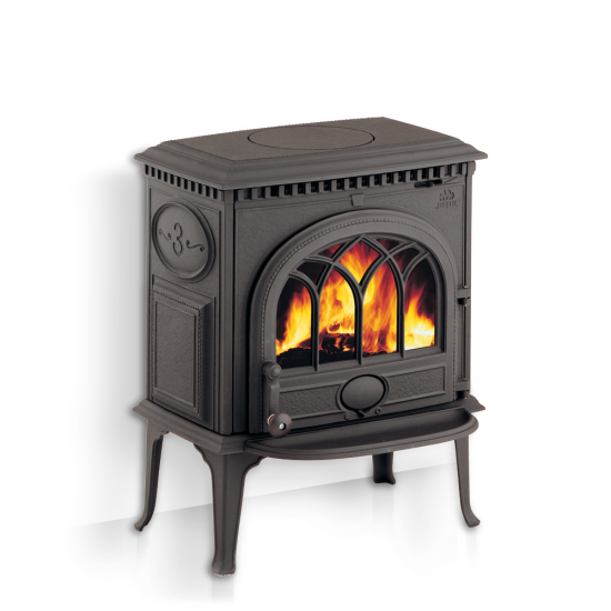

Toyota_mdt fortunately had the equipment at hand to build his stove here's his thread on it: Toyota_Mdt's stove build thread
The little Jotul 3TD I have is as complicated at Toyota_mdt says if not moreso and the instructions hit heavily of sealing every seam for every panel with a special high temp furnace cement. I get visions of smoke coming out of all the seams.
The basic Jotul-3TD (discontinued) is shown below as I could not link the image in.
Jotul 3TD Parts

Basic Jotul-3TD stove

Steve, its perfect. I can shut it down as far as I want, to the point of even putting the fire out. I barely crack one vent and close the flue damper at bedtime and it stays at a nice temp and still fire in the AM vs being out by 3AM and cold. I had plenty of windows to open, but it would still be too warm.
I did find my flue damper gettign glued or sticking shut. I suspect I am producing creosote now that I am able to shut it down. So I will have to heat it up well every now and then, probably at the beginning and the last fire and in between if I am there long enough.
The stove is literally air tight. I have welded all the seams fully, inside and outside. No stitch welds, full welds along the entire seams. I know its not EPA certified, but it works and its very safe. I do not have an engineer degree, but have the mind of an engineer to some extent.
If one was available in the specs I wanted, I would of bought it. As it stands now, the plate steel plus the labor to shear cut it was about $400. If you add in my labor, this was a spendy stove. Fortunately, I dont charge myself labor. This stove will still be structurally sound 100+ yrs after I have been deceased.

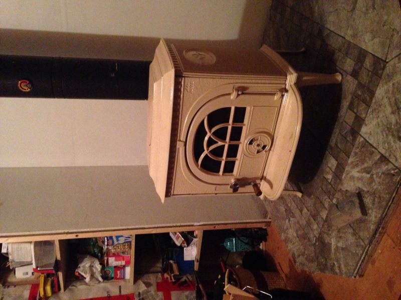

Steve_S,
We purchased a Jotul Model 8 on Craigslist. It is not hard to re-seal. The most effort is removing the old sealant before re-assembly.
Note: I checked for cracks during cleanup and the first few burns
Also thanks for the thread I will strongly consider one of those stoves for our bedroom addition.
