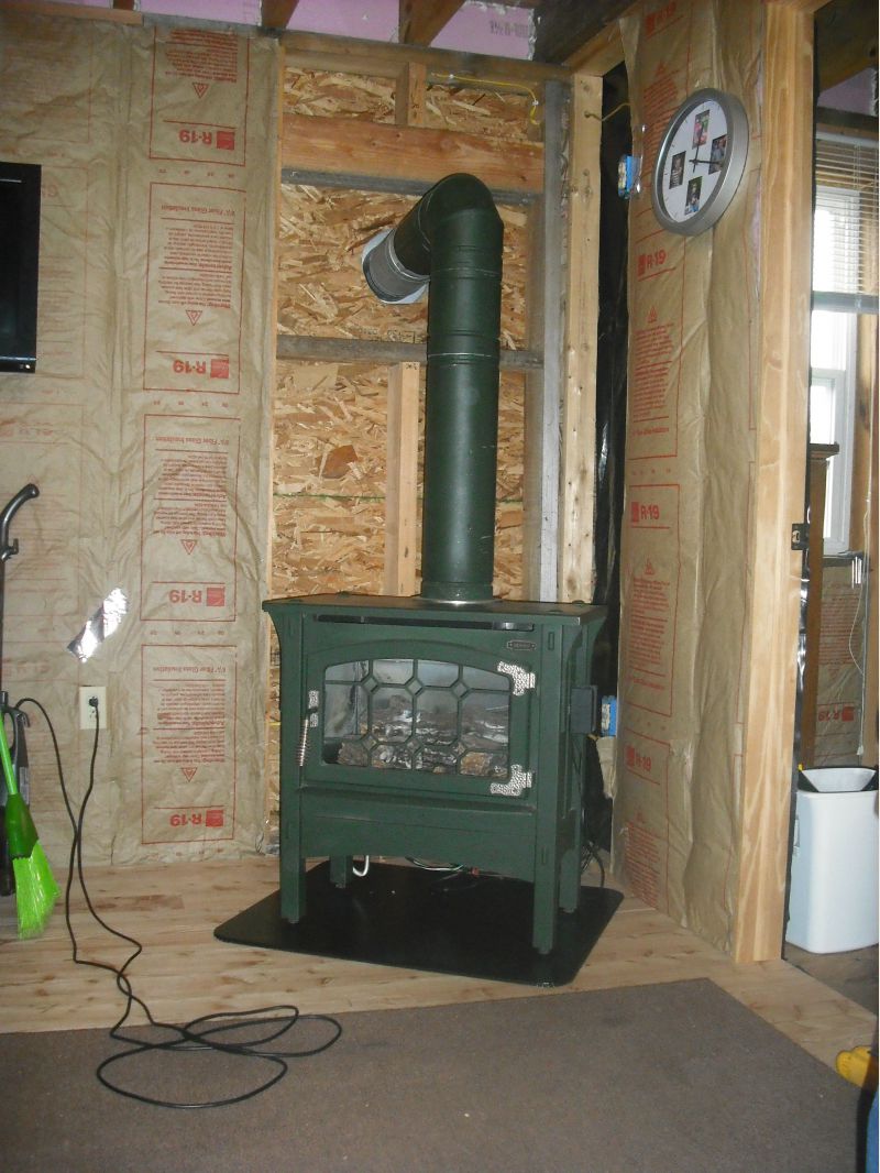

New direct vent propane stoves are pricey. I found a very nice one on craigslist for $525. It came with a wall vent kit, all the stove pipe. It works with no electric. We are really happy with it. There seems to be some decent deals out there
