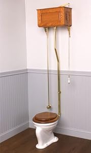

Maybe an alternative if you can't get pressure would be to go with a "High Tank" conversion similar to this historical solution:
Looking @ Amazon, complete units are in a word KRAZY ! But there is tank kits and pipe kits too... Maybe a do it yourself solution in the making ?
Link to Amazon Victorian high tank toilet

Ha! When I was in England, that is STILL common in a lot of buildings! Freaked me out at first to see a tank high up above the toilet. But IT WORKS!!! Can't see why you wouldn't be able to rig it up yourself!
