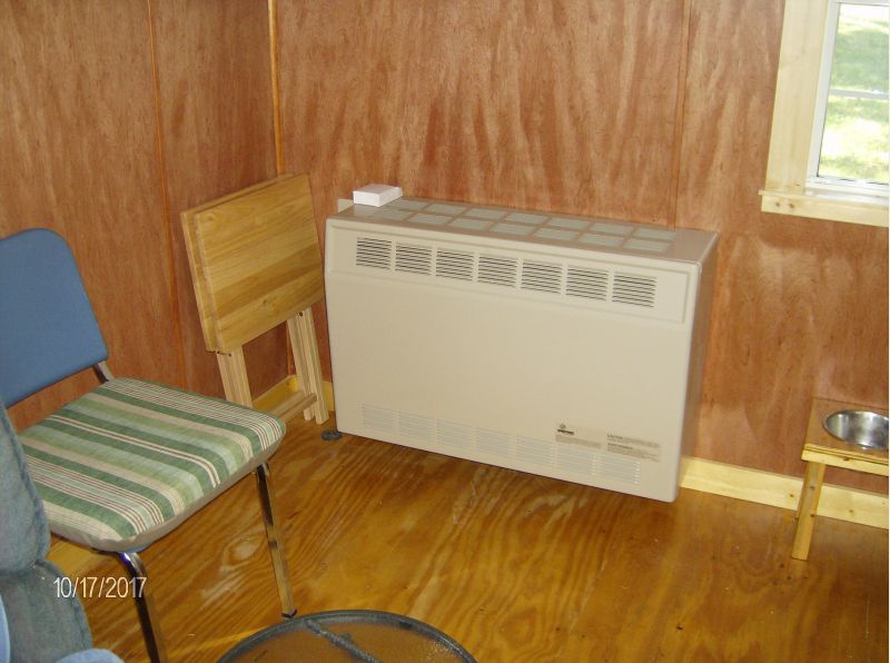

Bit the bullet and ordered the Ashley Hearth Products 11,000-BTU Wall-Mount Liquid Propane Vented Convection Heater. Drove the 45 minutes from Ottawa to Ogdensburg NY and placed my order. $503 US.
Now the math:
$502.94 + 8% (NY State Tax) is $542.94 US
In Canadian that's:
$542.94 x 1.264 Exchange is $686.49 CAN
Now add the HST
$686.49 x 13% is $89.24 (Paid to Customs Official at the Border)
Final cost:$775.73 CAN
Canadian price at Lowes:
$854.36 + 13% Tax is $965.43 CAN
Difference:
965.43-775.73 = $189.73
I did use about $14 in gas but saved almost that much by purchasing gas in NY State which is cheaper than Ontario.
Bridge tolls (x4) were about $13 Canadian
The whole process was very smooth and I was not charged any duty on the heater even though the box states "Manufactured in Argentina"
Now I have to pick up a regulator, hose and an extra tank.
Oh yah, install the heater.
If all works out the cabin will be nice and toasty without the fumes of my Little Buddy heater.

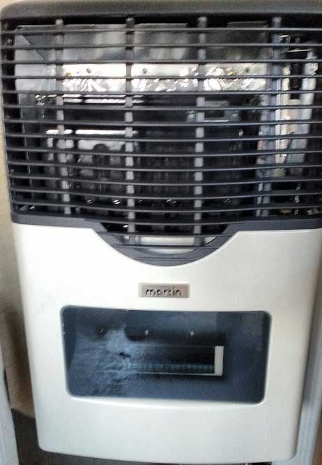

I don't know. all I know is I picked up my Martin and got it home, opened the box. Boy, it is so much nicer than my old "homcomfort." Smaller. heavier.
but hey. guess what. Its made in Argentina.

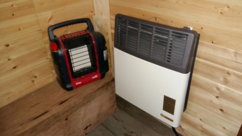

Find it interesting that your Ashley is the same colour as my Martin. Both also feature modulating flames. Something my older generation HomComfort did not have.
Oh. And the blue flame I was looking forward to using as a cheap TV. Meh. Coulda saved $50.

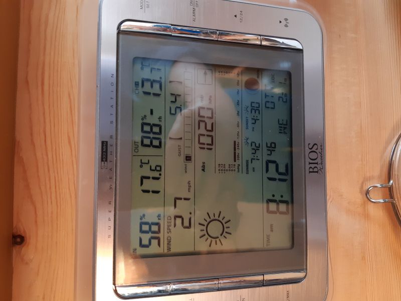

So it's a little chilly this am. Coldest stay at my cabin so far. Since I sleep in the loft I keep the hatch open all night but my celing is not well insulated so I doubt the furnace shuts down all night. Now this am I shut the trap door and just try to heat the main area. The furnace cycles on and off.
Not bad a 30° C difference between outside and inside.
