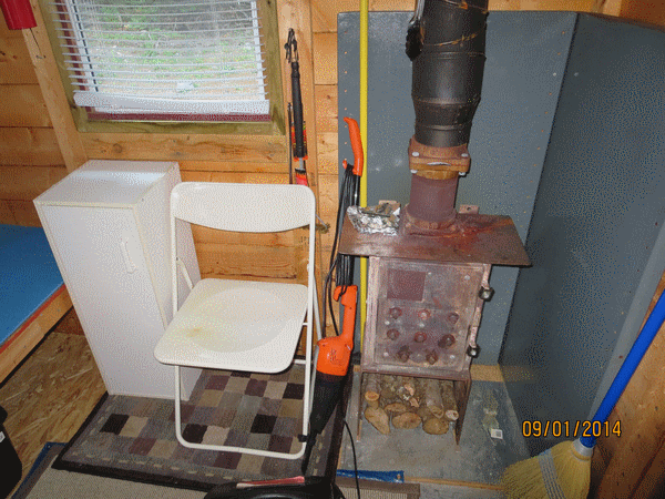

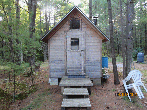

Greetings fellow 8x8'er! We inherited this bunkie when we purchased the property and with it came the "frankenstove". It is not insulated so it gets very warm when it's stoked up but things cool quickly when the wood is gone. The box is pretty small.
We keep a small portable heater on standby for the inevitable chill at around 3am. As always, Co2 detector and a cracked window are your friends.

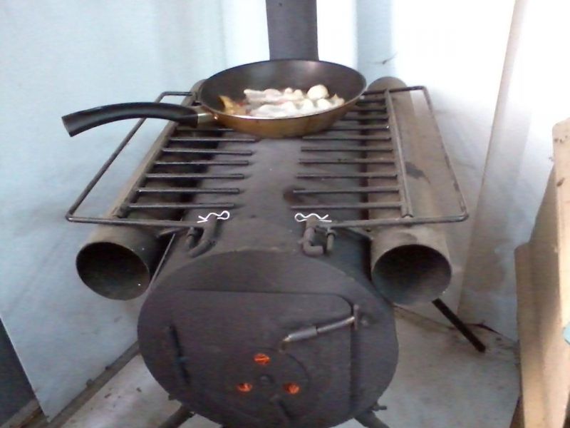

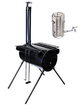

I have this in a 10 x 10 metal shed and it works really well, even in very cold weather. It warms everything up good enough to be able to work in the shed in short sleeves. It uses 2 1/2 muffler pipe for the flue, so if you need a longer pipe or any odd angle elbows, you can get it from any muffler shop....cheaply. It all comes apart and fits inside the stove for easy transport. I got it from amazon: TMS portable military campstove. $84.90. Free shipping I got the one that has the water heater that clamps on the flue pipe. It works great, but you can get it without that for $20 bucks cheaper. Picture1025151115_1..jpg
# Posted: 25 Oct 2015 03:15pm
Forgot to mention that I put sheet metal around it to reduce wall clearance. It is installed in a corner, and only sticks out 27 inches. ( there is wood behind mine ) so far the wood has never been hot when I touch it. Just remember to leave a small air gap between your heat shield and the wall. You could use sheet metal or cement board.
